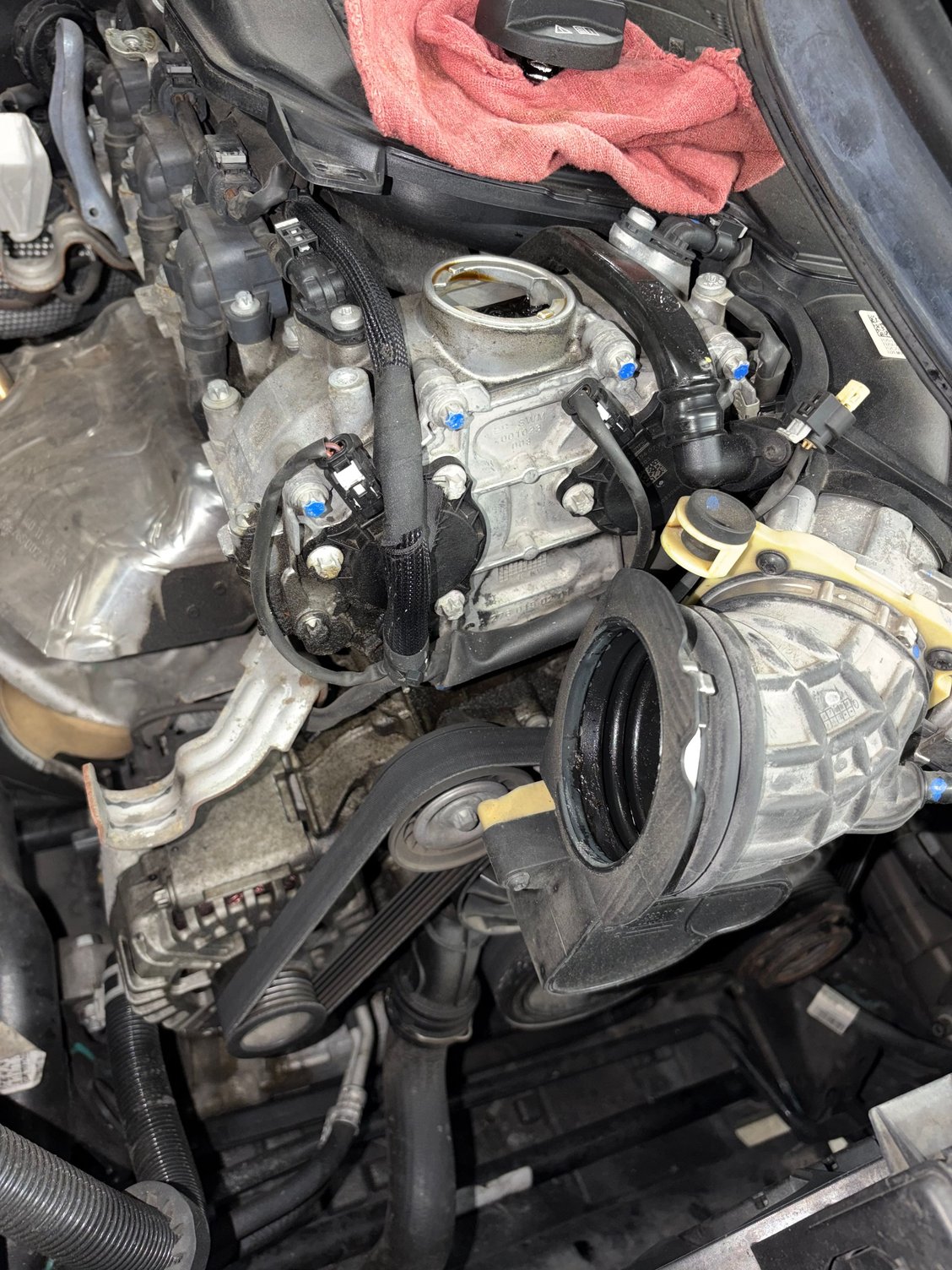

Photo of the timing covers? Sometimes the seep a bit, plus oil drips from previous oil services. Unless it pouring oil out of the timing covers, I would clean them up with a rag, brush and brake cleaner. Do not spray harness or electric connector. Then, monitor the cover for a few weeks. Ours are clean at 140K, 107K and 96K. Is the alternator soaked in oil?

Nov 2, 2025 | 09:09 PM
Quote: Photo of the timing covers? Sometimes the seep a bit, plus oil drips from previous oil services. Unless it pouring oil out of the timing covers, I would clean them up with a rag, brush and brake cleaner. Do not spray harness or electric connector. Then, monitor the cover for a few weeks. Ours are clean at 140K, 107K and 96K. Is the alternator soaked in oil?
So the alternator is soaked when i looked underneath, both upper timing covers are leaking. The independent shop is a highly reviewed shop and told me that the oil can make it through the wires, then up into the ecm module and other issues that can come from it if I don't reseal both. It seems to be just the upper timing covers are leaking as the rest of the car is flawless. I cant tell if my startup has a rattle but it does start unusually loud. they told me it can be the cam adjusters and could be a 2k+ job, resealing it is about 400. What do you recommend?

Nov 2, 2025 | 09:54 PM
For sure reseal the front cylinder head covers. Only you and your mechanic can decide if there is a startup rattle that needs to be addressed.
Insect the cam position sensors and cam magnets fornsigns of oil in the connectors. It is almost for sure there with a car this old. Replace the sensors and magnets. Check the ECU connector for signs of oil and clean it if needed.

Nov 2, 2025 | 10:07 PM
Quote: So the alternator is soaked when i looked underneath, both upper timing covers are leaking. The independent shop is a highly reviewed shop and told me that the oil can make it through the wires, then up into the ecm module and other issues that can come from it if I don't reseal both. It seems to be just the upper timing covers are leaking as the rest of the car is flawless. I cant tell if my startup has a rattle but it does start unusually loud. they told me it can be the cam adjusters and could be a 2k+ job, resealing it is about 400. What do you recommend?
Definitely leaking front the bottom, or the actuator seal.
Now, a mechanic that tells me the oil leaking through the timing covers edges, or through the actuator seal can make it to the ECU will automatically loose complete credibility with me. The oil in harness issue has nothing to do with this kind of leaks, but oil through the physical plastic of the actuators, the plastic of the camshaft position sensors, oil pump solenoid, and possible other similar component. You can have oil in harness issue w/o a single visible drop oil outside until it is so much oil in the connector the connector will leak it out.
Since the timing covers will be already out, I would definitely replace the chain tensioners just because it shouldn't be much more cost wise.
Since the VVT are also visible, worth doing a manual test to check if any VVT is already failing.
Check every connector for oil in harness. For a 2015, it can be hit and miss. We have 3 of these engines (2012, 2014, 2015), none have leaked oil from anywhere, timing covers, seals or through the connectors. It can be weather related due to the seasonal cycling. Ours are Florida based, i.e. narrow temperature range that North based vehicles.
