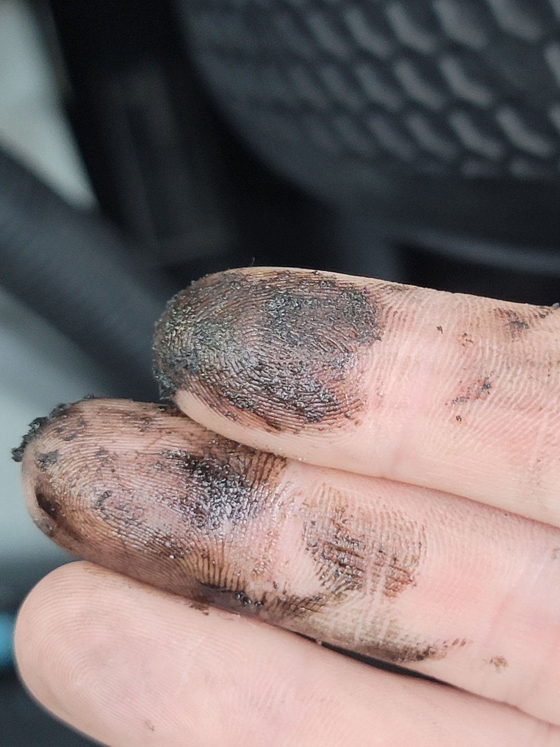

- I also noticed black grease around the alternator, especially near a cap/connector area, with baked-on residue on a nearby coolant hose (photos attached below)

your alternator has been detroyed by the engine actively leaking oil into it.
greasy ALT + coolant pump inlet
This standard oil leak is from the magnesium upper timing cover failed RTV seal.
Note: the timing cover fasteners are "one-time use" aluminum... they'll snap to preserve the shallow head threads.
