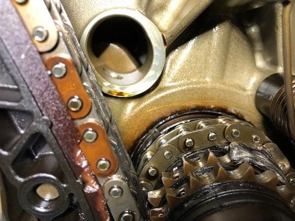

Check out these pics from another 275 thread where the engine jumped time, luckily not from those rubber pieces. It's the only pics I could find of the sprocket in question.

What the heck is that spider-web-looking stuff on the sprocket just behind the front sprocket? It looks like some kind of gunk.
That is the main crankshaft bearing that shot out into the timing gear causing the chain to jump teeth and bend the valves, apparently!
That was my disaster. She had squeaked as a noisy drive belt. Replaced the serp belt and bearings for accessory drive.
Lit her up... Sounded good. Go for test drive... Made it 100' when it quit. Cranked slowly. Towed back into the shop.
Borescope revealed that exhaust valves met pistons. Front main bearing had spun in it's bore. I always gave her Mobil-1 and changed on time. Jay and I had recently done one of those very amusing drives that included much savagery. Never got beyond pulling the timing cover. The dead lump went to the recycler last week. Replacement runs great. Burns no oil. It was a treat to replace.
