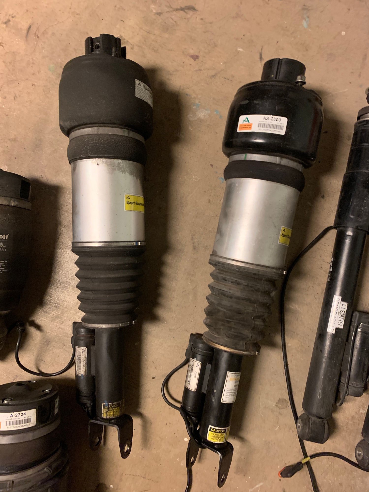

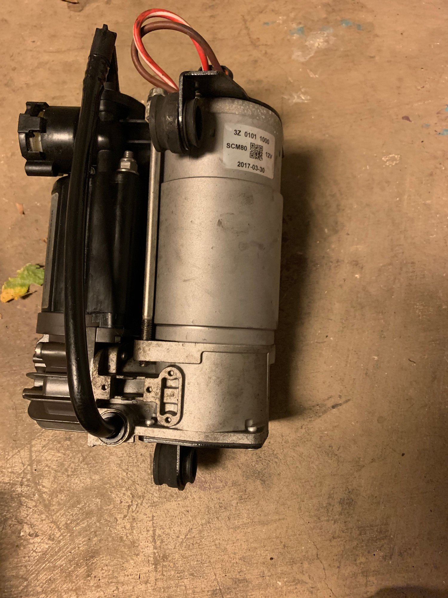

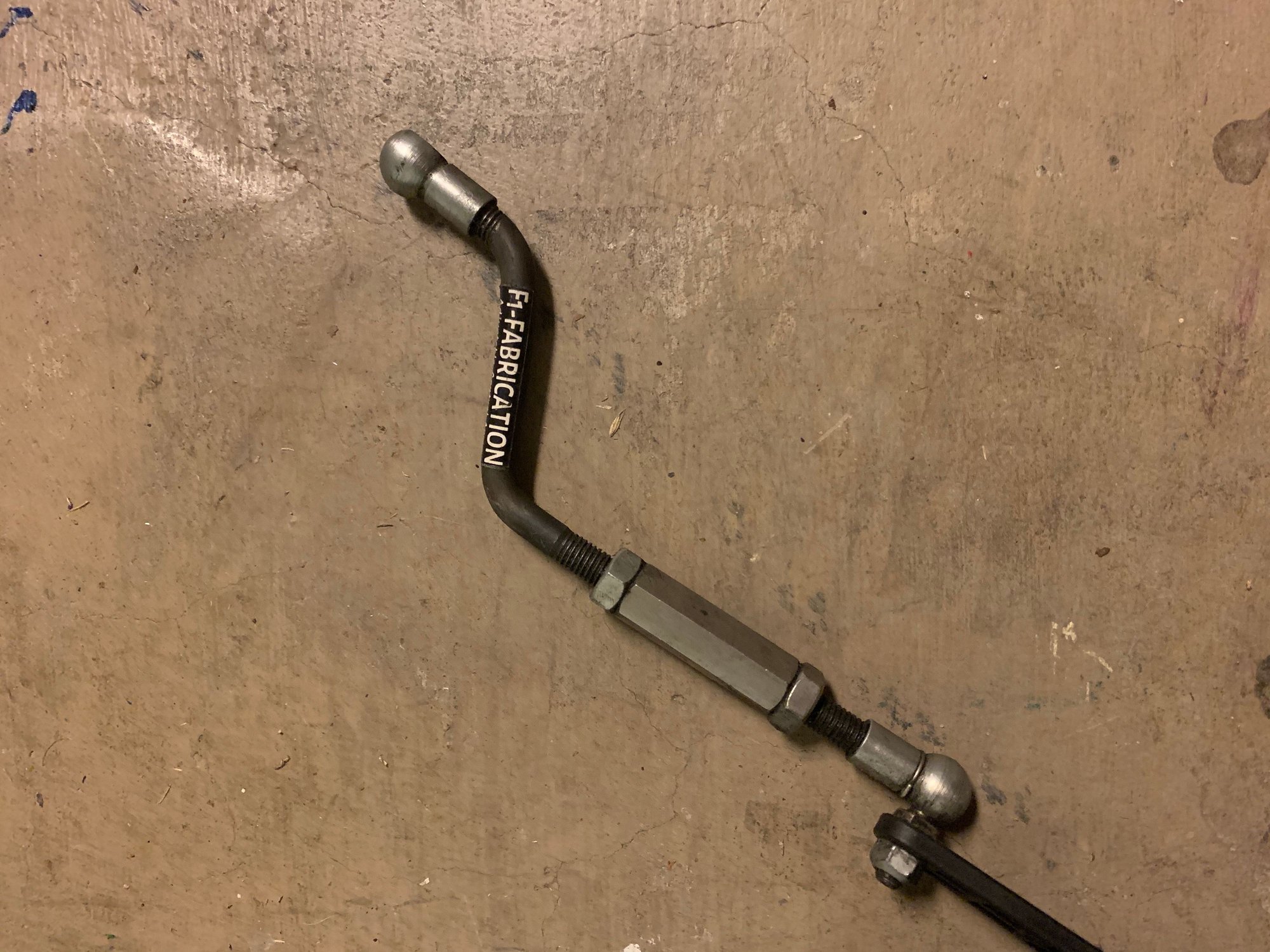

Selling all the shocks, airbags, struts, air pump, hoses, tubes, valve block, airmatic/shock/parking combination control switch height sensors and steel F1 fab height sensor links. Please let me know what you need and I'll let you know the cost+ shipping. The system was working properly with no errors or warnings.

How much for both rear air bags. Area code 94541.
Thank you
