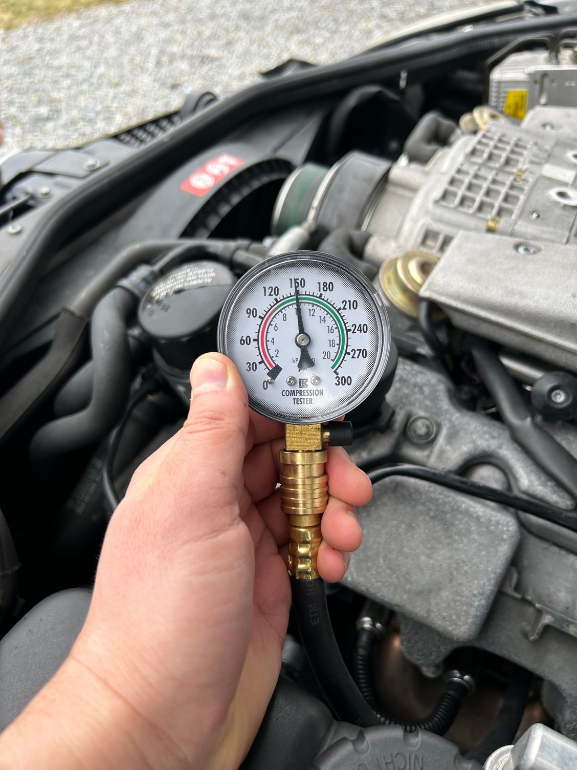

No problem! It started misfiring at 17+% throttle and I babied it home. It then had an ESP error and the SCB light popped on and off intermittently and the fan would kick on high and not crank. I got a used (and flashed) ecu from RaceIQ and put it in the car and it started and idled fine. I let it idle for about 5 mins before taking it for a test drive and it started missing every few seconds, then it got super rough and shut off. I pulled the codes and a couple injector circuit high and a TPS code came on so I put new injectors in, a new TB, and while I had it apart, replaced the valve cover gaskets and resealed the breather covers as the driver’s side was leaking a bit. Put it back together with new gaskets and proper torque specs and it started and misfired again. I think it is something in the harness or electrical system.

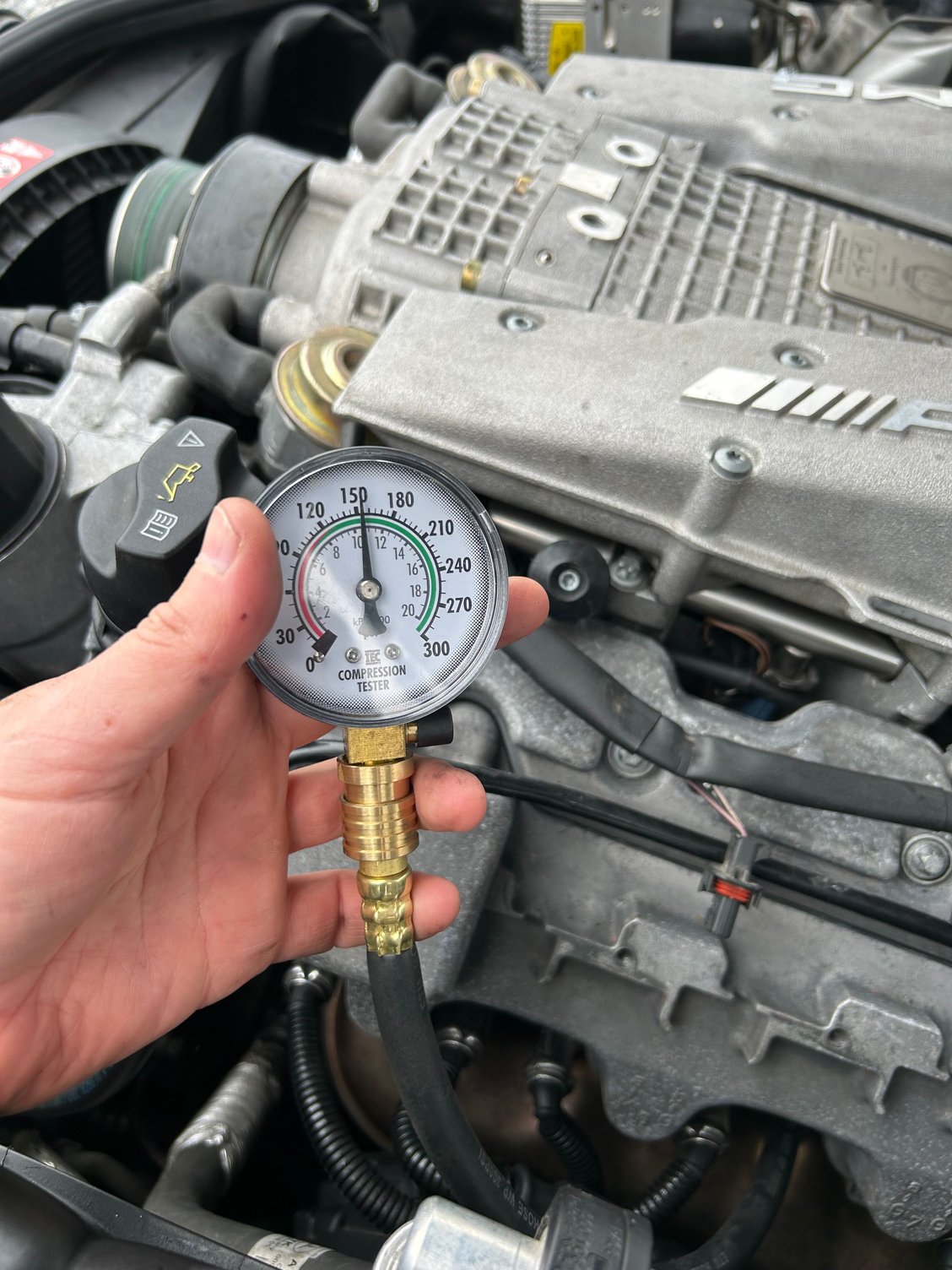

Drivers side compression, ran out of daylight.

Finished compression test and put new battery in. 150+ on all cylinders. Retested 1 and got a better reading.
