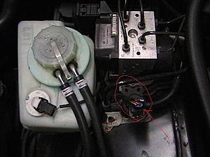

There is something labeled MOT directly behind the windshield wiper fluid reservoir on my E320. It is making a lot of clicking sounds, and it doesnt do this on my friend's C230, so I was wondering if i should replace it.
Does anyone know what it is? Also should i replace it if it is intermittently clicking very loudly?
Attached is a picture with an arrow to it and a closeup.

That looks like the recirculating pump for your heater. Have you been having problems getting sufficient heat?

its the PURGE VALVE for the fuel system. the clicking is normal and does it intermitently.
thats good to know. it worries me sometimes. i thought my lifters were ticking but when i popped the hood, i saw that valve and held my hand tightly against it and it stopped.

wrap it with some thick black felt tape from mb dealer and it wont bother you again ,

As suggested, felt tape does wonders if it really bothers you that much. Unbolt the bracket that holds it on, and place tape between the bracked and where it mounts to sheet metal. Should help with noise a little.
