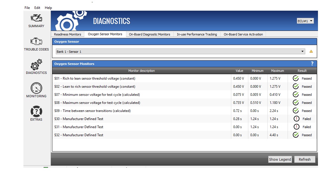

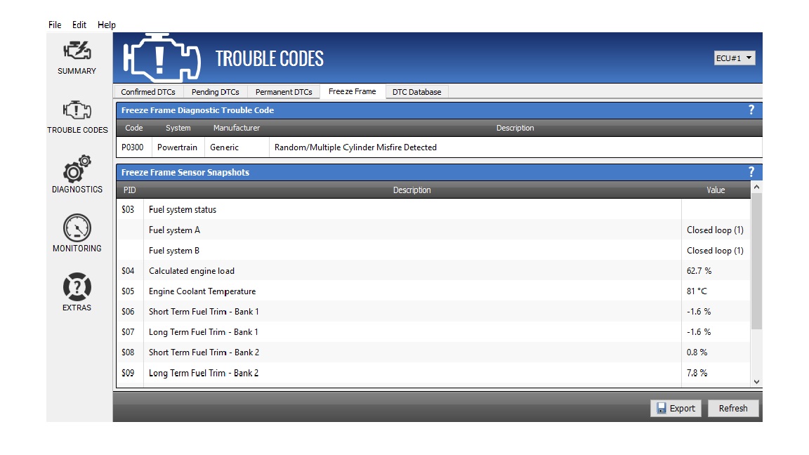

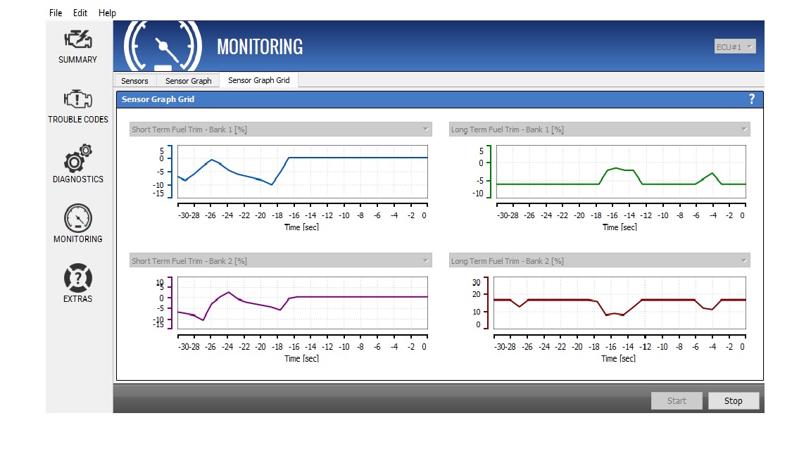

Hey I got error codes p0300, p0301, p0302, p0303...
Its a real mess I guess because it can be so many things...
I just changed the MAF but this didnt help... I've added Fuel injec cleaner, didnt work. So I started to think about the O2 sensors... And I read them off, just need some help to read them as I have low knowledge of this.
What do you think of these readings? When I restard the car its fine, until I accelerate, and it starts to shake and goes off on cylinders. Turning it on and off again its fine until acceleration, also happens in gear PARK when I take down the to about 3000+ rpm.
