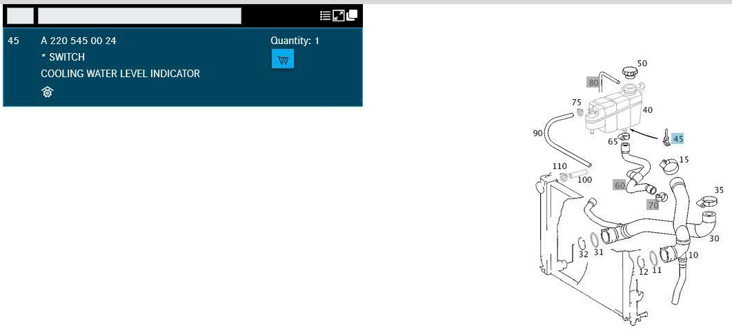

Fluid brand or where it was purchased have nothing to do with this issue. It's probably your coolant level sensor the one that is having an issue. The windshield washer level sensor(S42) and coolant level sensor(S41) are wired in line. They report directly to the right fron SAM control unit (N10/7). Pin 16 and 19 of connector 3 at the SAM. I used to have W210 that would show low coolant but it was the W/W fluid that was low.

S41(coolant level) Coolant level full should be 110 Ohms and <5 Ohms with level empty. S42(Windshield washer) Washer full should be 160 Ohms and <5 Ohms empty.

thank you for this information. it is very helpful. one more question how do i determine if i have an S41, or an S42 windshield washer bottle. my car has the heated bottle and it is a 2004.

Two different sensors: S42 = windshield washer fluid level sensor that you already replaced, S41 = coolant level sensor @ coolant reservoir.

thank you, got the coolant level sensor installed with the with the proper resistor and no more check windshield wiper fluid message. i do have one more resistor type problem. the wiring harness in my trunk for the check license plate lights had a break in one of the wires. i attached the cut wires with a connection fitting. based on my experience with the windshield wiper reservoir resistor, i am guessing that i need to put a resistor wire between the connection fittings that i used. would the resistor wire be the same size as the resistance wire for my coolant level sensor which is 110 Ohms is this correct size to solve my trunk license plate fault code? i would believe it is, but would love verification of the resistance size wire needed for the trunk wiring connection. again my car is a 2004 mercedes cl600
