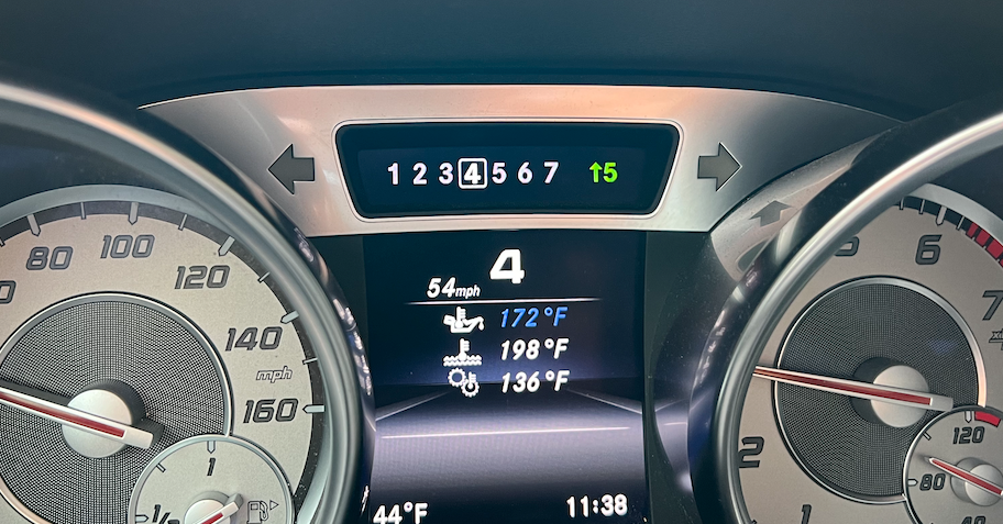

I had @BenzNinja code my instrument panel with the AMG menu, which is a nice feature. My instrument panel temperature gauge is showing ~92°C which equals ~198°F.
I'll have to check with Peter to see if it's available for mine as it's a 14' E350 W212. My dash...Instrument cluster is much different than yours. I have a couple other things I need too.
