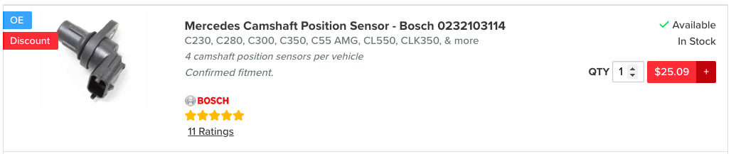

Look up the parts and prices at www.fcpeuro.com, www.autohausaz.com, or www.pelicanparts.com. I think you will find your parts MUCH cheaper. For example, four Mercedes OE (Bosch) CPSs should run about $100, not $300!
