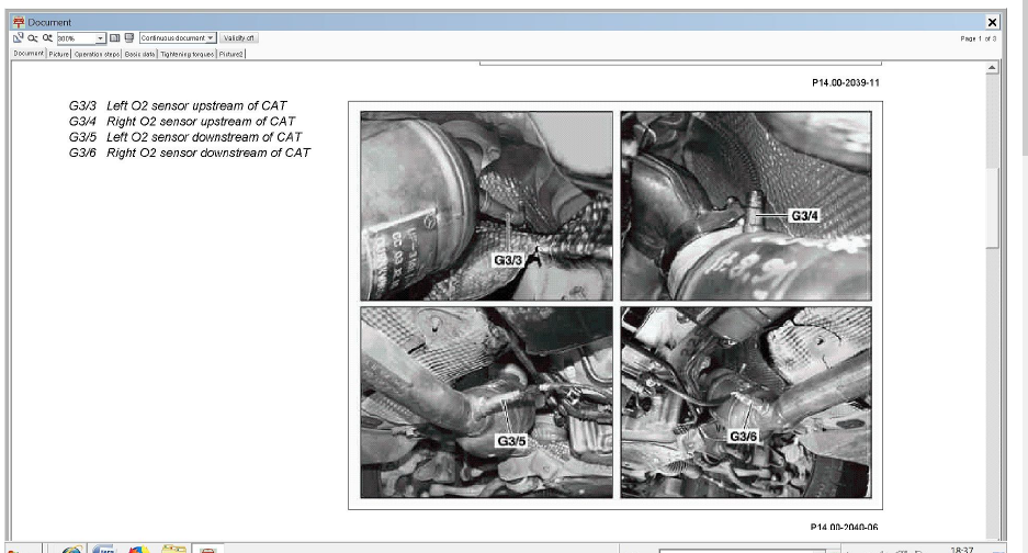

My CEL remains on. We made no attempt to clear it. Please correct me if I am wrong, but are all the relevant sensors around the first two cats immediately behind the engine? That's what it looks like from this picture I pulled off the web. Are there any more sensors behind it? If there aren't why did I get a CEL? I am hoping the light came on when one of them clogged momentarily and someone can clear it now and it stays off.
