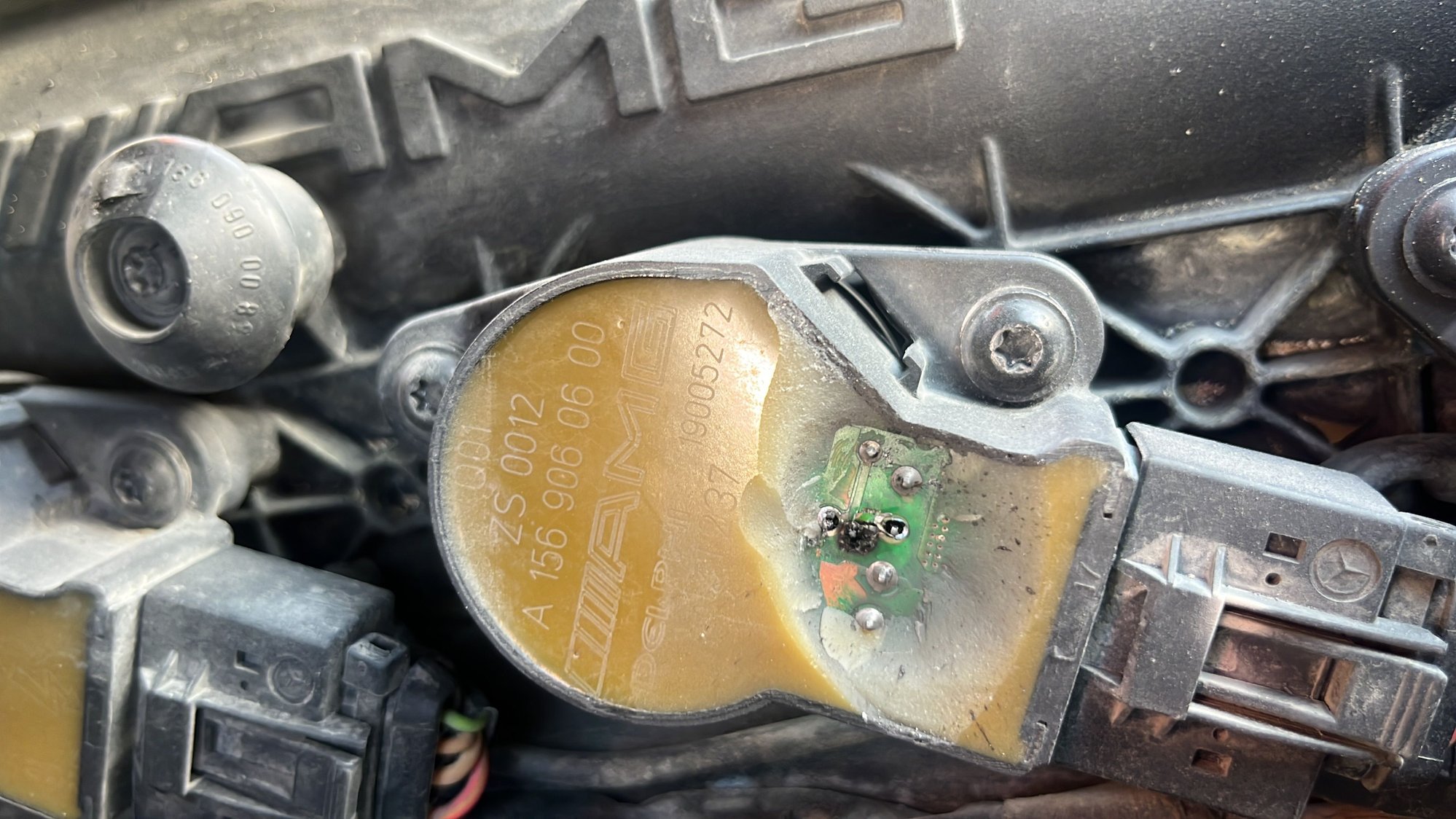

Hi Guys I currently own a c63 as named in the title, Went for car wash initially and the very minute I drove away I could smell a electrical smell I turned off the cabin AC and the smell went away, Turned the AC back on again the smell was coming through again (Electrical smell) I thought maybe water had ingress into the rear boot as my speakers were all crackling, I checked and the boot/trunk was dry along with the amp. The following day I went for a hard drive in sport plus as I did a kick down the car went straight to misfire and died on power, I pulled over to restart the car but still the same and pulled over again when I turned it off the car wouldn't start at all, when I opened the hood there was smoke coming from 1 blow coil on the left hand side ( if your looking at it) 2nd one in was blown (picture attached) 3rd one was black on top and had melted the airbox. Car wouldn't turn over just give ignition.

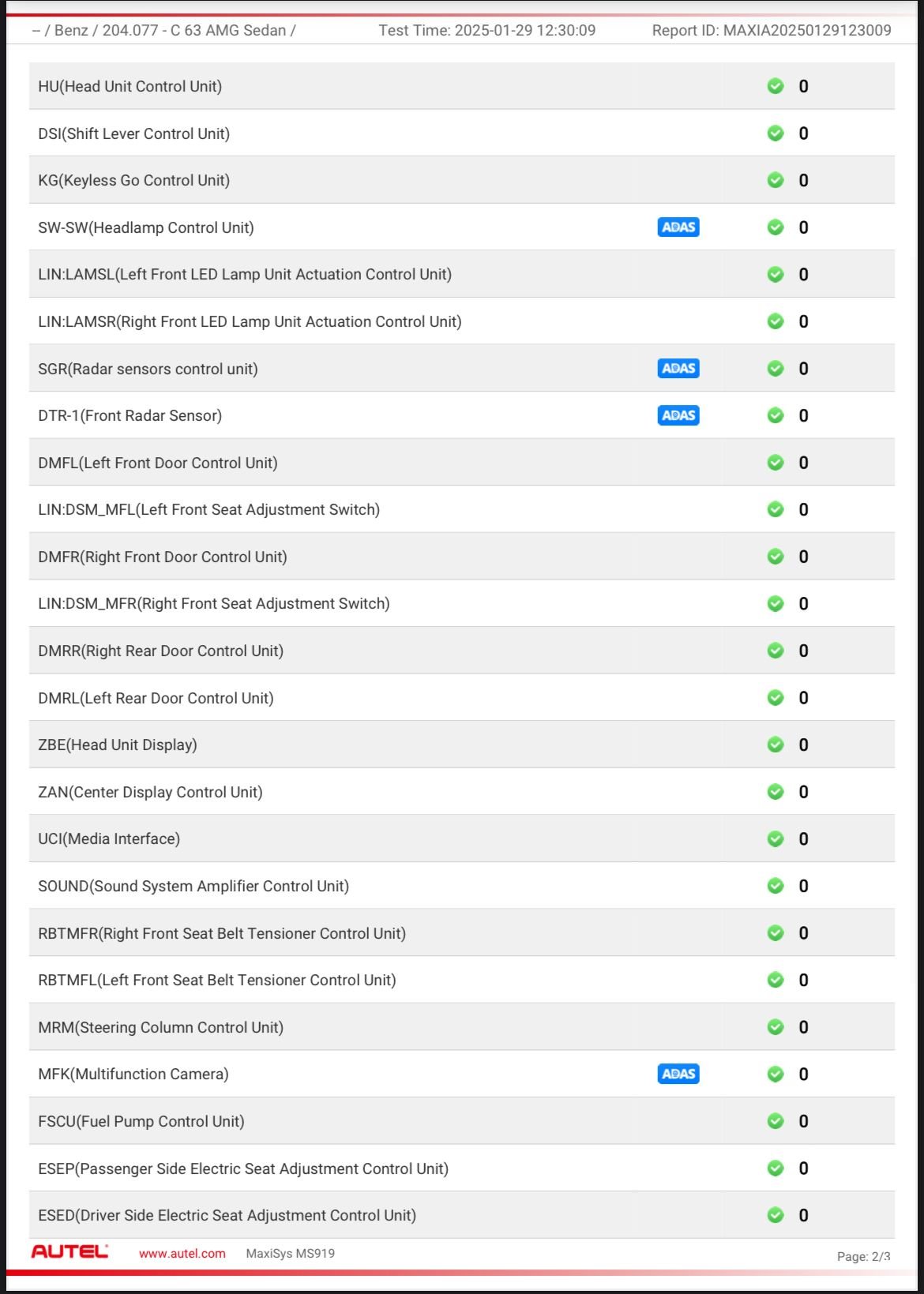

Fault codes attached

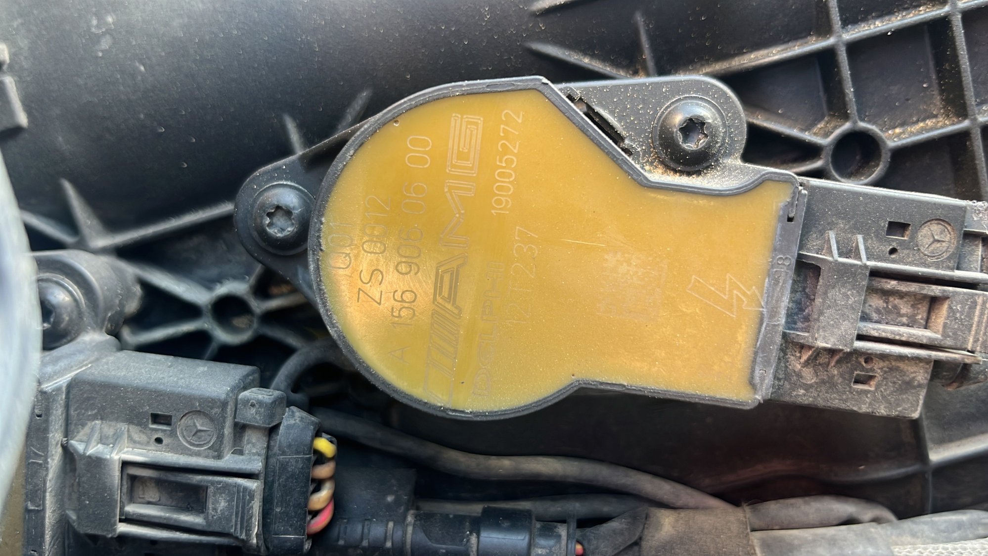

its worth nothing the whole left bank ignition coils were all slightly discolored bar the ones that burnt of course.

Also the set of faults hints that your chassis has seen low voltage which is known to disrupt CAN Networking.
