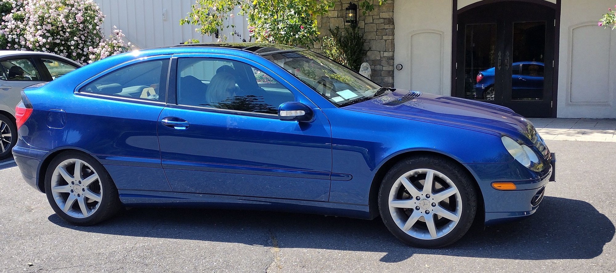

OK, so I bought a positively gorgeous blue (IMHO) like new M111 powered 2002 C230 Sport Coup sight unseen with just
35K miles, California car, no rust, and Carfax maint. going back to 2005 when the 2nd and most recent owner purchased.
Always repaired by dealers or German car specialty mechanics with a brand new set of $1000 Conti tires.
I figured it was a no brainer.
It was one of just a few of these M111powered available anywhere but also happened to be within 30 miles of the airport
that our little local airport flies directly into.
SOOO....I get there, yes, it's beautiful and like new. I've already bought and paid for it.
