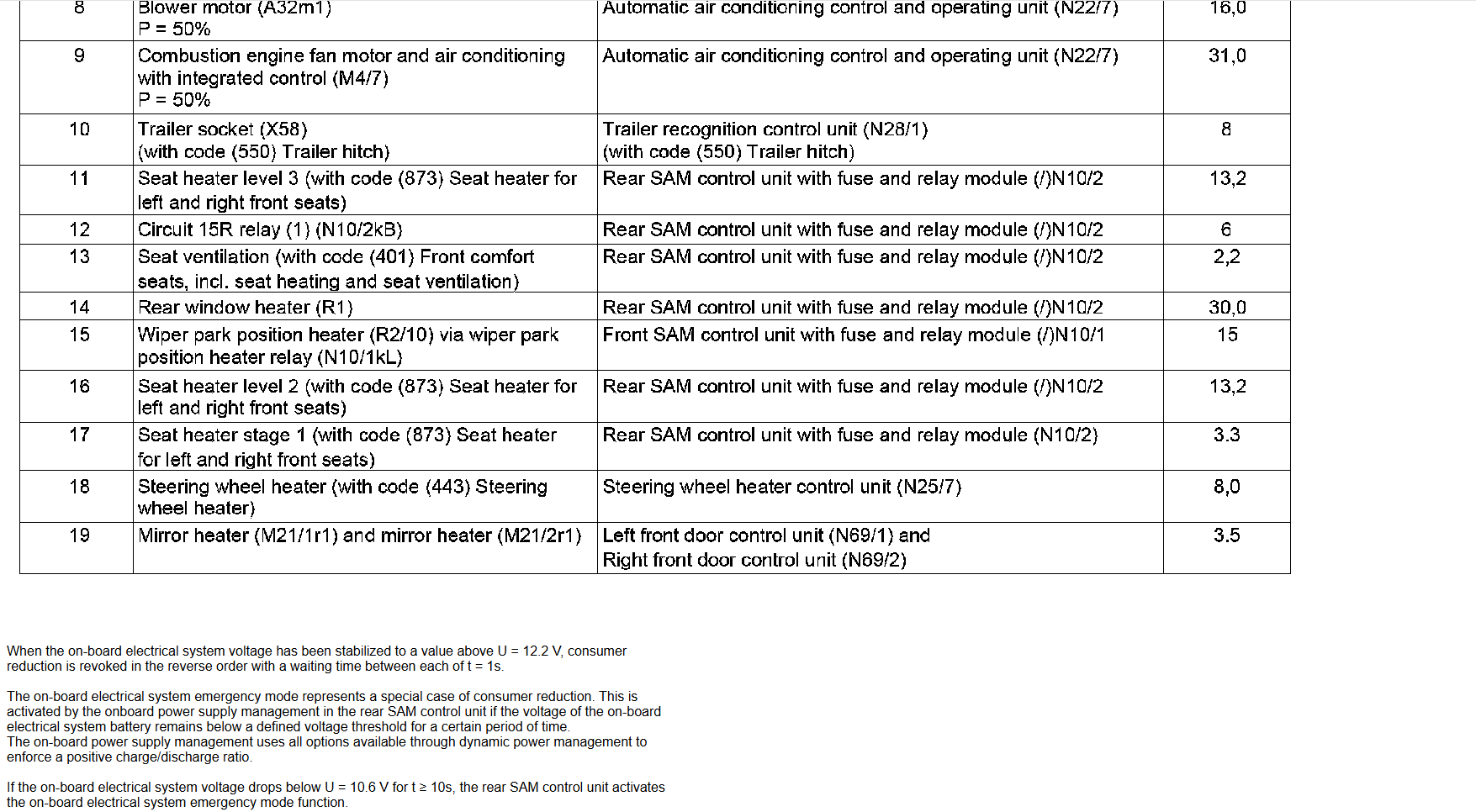

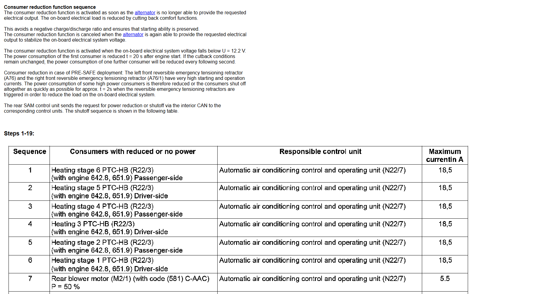

Comfort functions being shut off makes sense if the battery/charging is low. I remember coming across this info researching when I had a red battery warning.

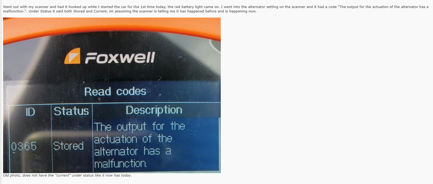

I had made a thread on it documenting what I had tried: https://mbworld.org/forums/c-class-w...-readings.html

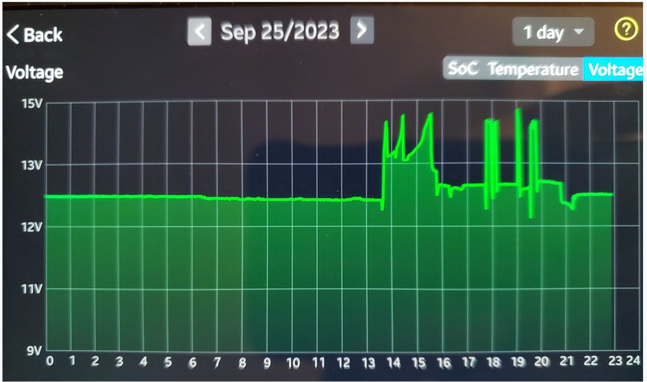

During that time is when I bought the Ancel bluetooth battery monitor which I think was handy for determining the alternator was fine and not the issue. Since its connected directly to the battery it tracks and records battery voltage even when the car is off. I was able to open the graph and see what the car was doing, see how the battery was being charged and being drained. But i also have my Foxwell obd scanner which wasnt showing any faults. I think scanning the car would be the first step.

Seems I did have a code for the alternator. Been so long I forgot. Still, the issue went away.

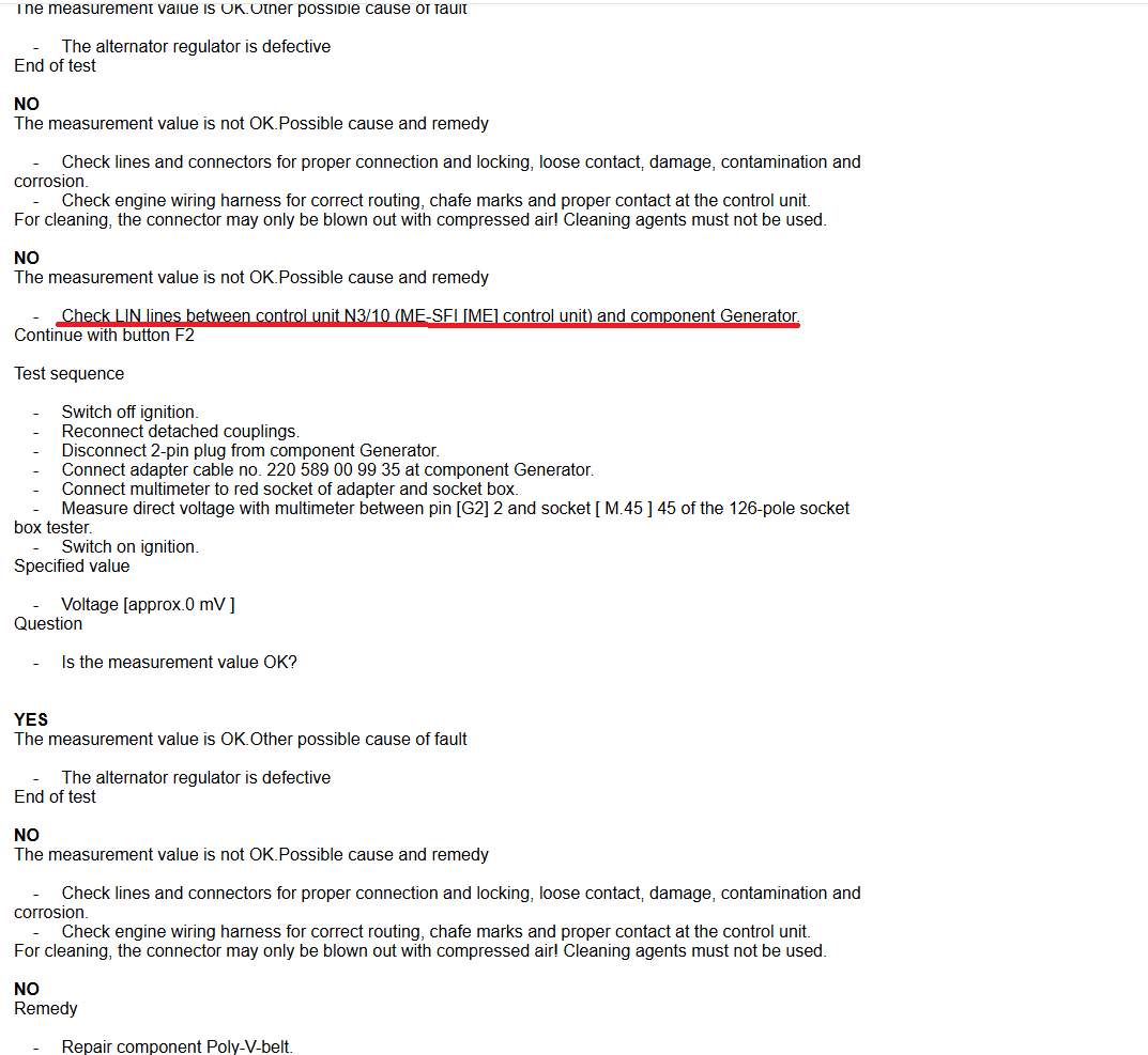

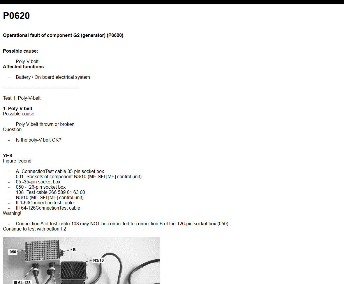

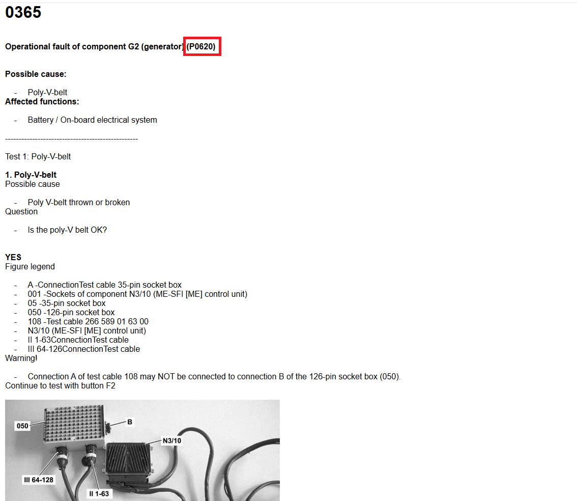

At the time i had the fault code for the alternator I didnt have access to the manual. Just for fun I looked up that code and seems to point to the poly-v belt. Wonder if not running the car for a few days maybe had some condensation on the belt and it was slipping when first starting the engine? I live right on the water and I notice alot of times opening the hood and everything seems damp. For that code it mentions checking the LIN, wonder if thats what you mean?

Troubleshooting guide pointing at serpentine BELT at the source of trouble for ALT voltage chaos is overly simplistic.
Granted it's not simple but the ECU has enough data to know what voltage it is requesting from the ALT.
-- I'd say 1dt step is to collect evidence by driving with IC-Display to show battery sensor (VOLTS/AMPS).
-- Prevent drain by locking doors when car is unused.
-- Consider using an automatic battery float charger to fully charge batteries.
besides scanning for clues.
