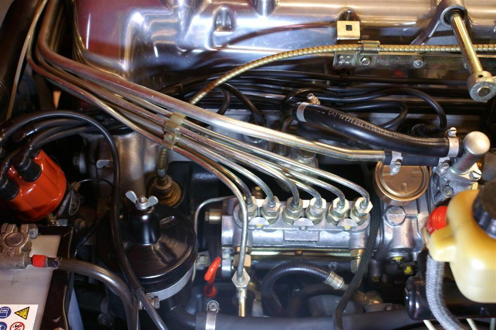

Old Jul 13, 2025 | 07:40 AM
vinceC's Avatar
Joined: Nov 2001
Posts: 789
Likes: 55
From: Henrico, Virginia
2014 ML350 4Matic
Your symptoms seem related to the cold start system. In the photo, refer to the vertical cylinder on the far right with the two cooling system connections. That contains a wax bulb, similar to that found on the cooling system thermostat. As the coolant warms the expanding wax extends a pin into the governor section of the injection pump where it acts to adjust the fuel mixture. On a cold start the pin is withdrawn and the governor delivers a richer mixture. As the coolant warms the pin extends and the governor leans the mixture. Normally failure of the bulb would lead to a very rich mixture and poor fuel consumption when warm, so I doubt that is what is happening. But understanding the function of this device in the cold start system is important. I suspect there is wear or damage in the governor section of the pump that is allowing the mixture to go too lean as the coolant warms and the pin extends. I would seek an experienced specialist to look at the injection pump. Do you know if the pump has ever been serviced? One thing most folks don't know or choose to ignore - there is a dipstick on the governor section. The governor takes a small amount of engine oil to reduce wear of the governor internals.

It is absolutely good advice for him to confirm the above specs. However, from what the OP states, the engine runs well at higher RPM when fuel demand is greater, leading me to think the problem is elsewhere. The mechanical injection pump is just that - mechanical. Pressure to open the injectors is created by the plungers in the injection pump. The governor section controls fuel delivery quantity and "inputs" (such as the cold start thermostat) to the governor are mechanical. While the thermostat itself appears to be functioning correctly it is acting on a mechanical device subject to wear. With a pump of this age (circa 1965/67) there is a definite possibility that the thermostat is causing the governor to "over correct" the position of the fuel rack, thus leaning the mixture too much. Or - those are pretty rugged pumps, but the plungers could be worn, the rack worn, the three dimensional cam in the governor has worn, etc. If the OP finds the fuel delivery within spec, next stop should be a specialist - which may be difficult.
