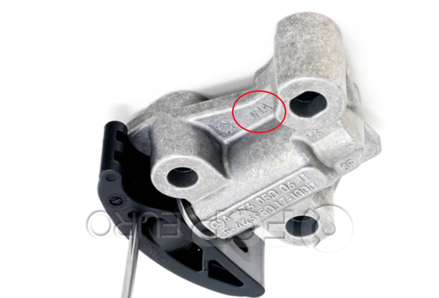

I usually look at the part to see if its stamped with the manufacturer. Thats how i knew in my M272 the thermostat is Wahler, belt tensioner is Gates etc.
I dont have the M276 so dont know the part #'s off hand. What are the part #'s you are looking for?
Found a timing chain tensioner but not sure if its what you are talking about. Looks like it is stamped INA on it.

For cam adjusters and tensioners, INA is the OE supplier for a lot of Mercedes engines. They're top quality and usually a fair bit cheaper than the dealer parts. Definitely the brand I'd go for.
