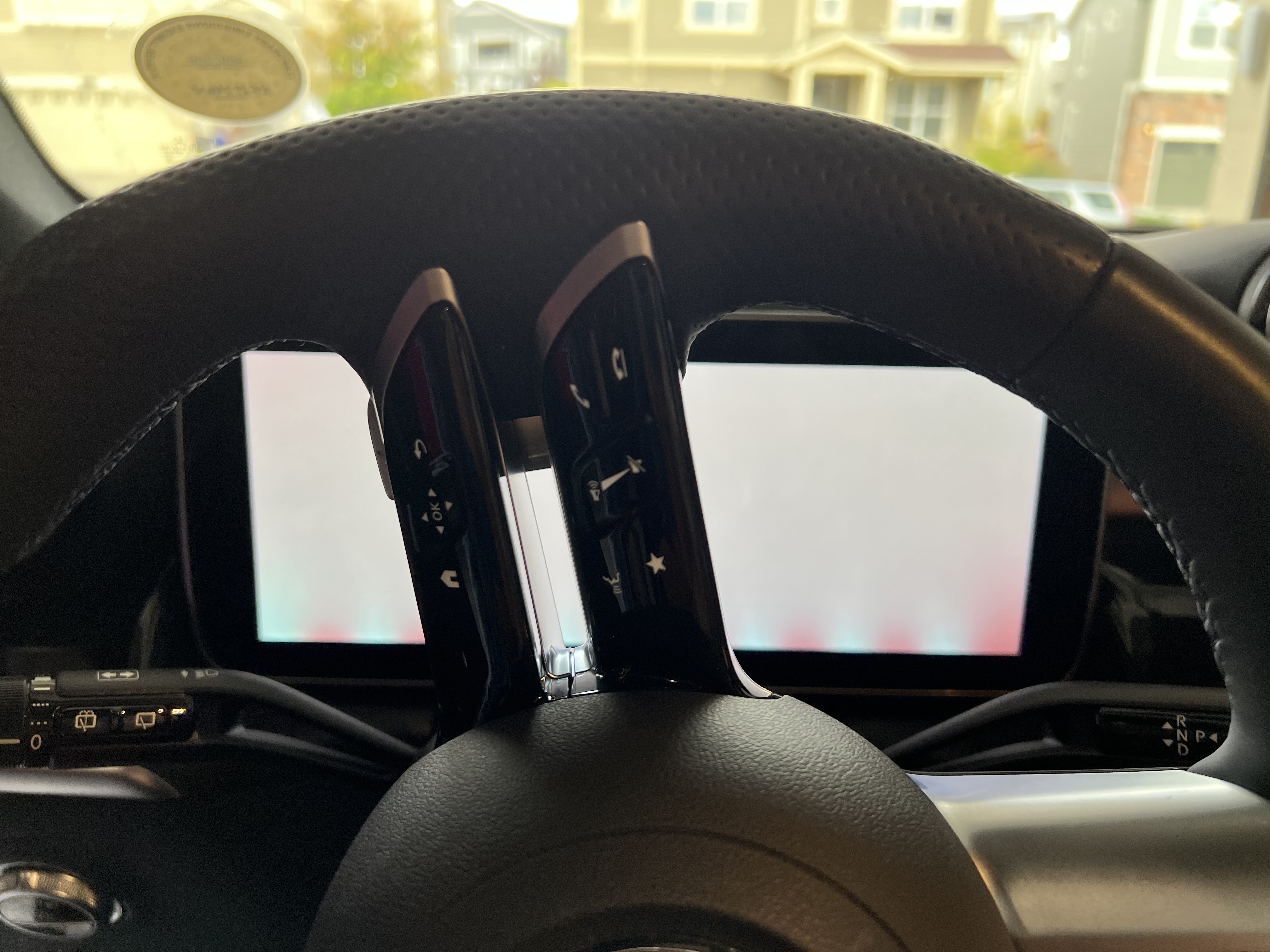

Hi all,
I purchased a GLC 300 last year and it’s had a number of electrical issues that the dealer either can’t recreate or can’t find in the cars error registry. Problems range from random warnings about sensor failures to cooling fans randomly reving up and down while the car is off and has been sitting for hours,
to the instrument cluster going to a blank white screen.
has anyone seen these issues before or know of a fix other than a “software reset”?

I'm sorry to read about your degraded Mercedes ownership.
This is not too bad until the powertrain quits while in traffic at 70mph
What you've described involves a combination of faults with the ECU on CAN-C and the Cluster on CAN-B...
What's in common is a network gateway rendered unstable by other faulty modules - It is referred troubles such as wet HL Modules or loose something else....
To troubleshoot this further a full scan will confirm what modules are actively faulty.
This maybe a simple fix unless many expensive modules get replaced with little results.
Basic troubleshooting is now your priority. Using an handheld scanner will give you result where Xentry was useless.
