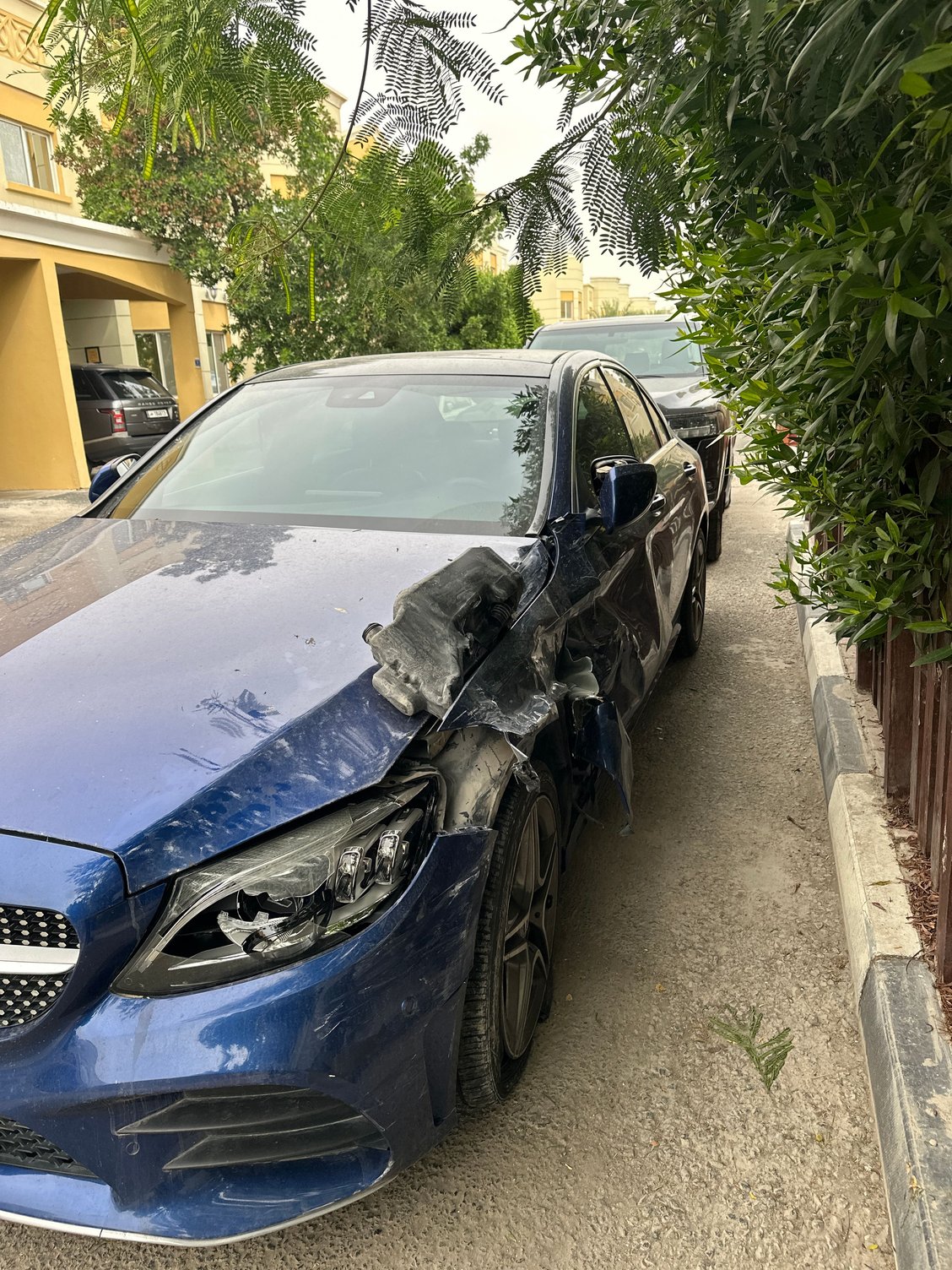

I was involved in an accident, and I’m trying to understand the extent of the damage before relying on the insurance assessment.
The car is a 2020 Mercedes-Benz C200 (W205).
My main concern is whether this has reached structural/unibody components or if it’s still considered repairable without major chassis work.
Thanks in advance.

Of course this is repairable but your claim adjuster interest is to salvage your wreck for parts.

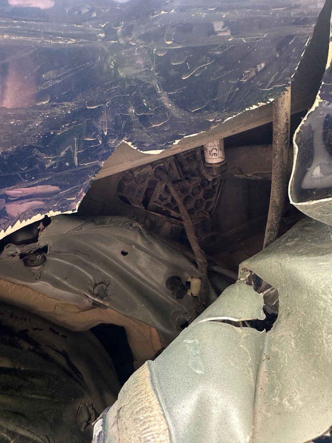

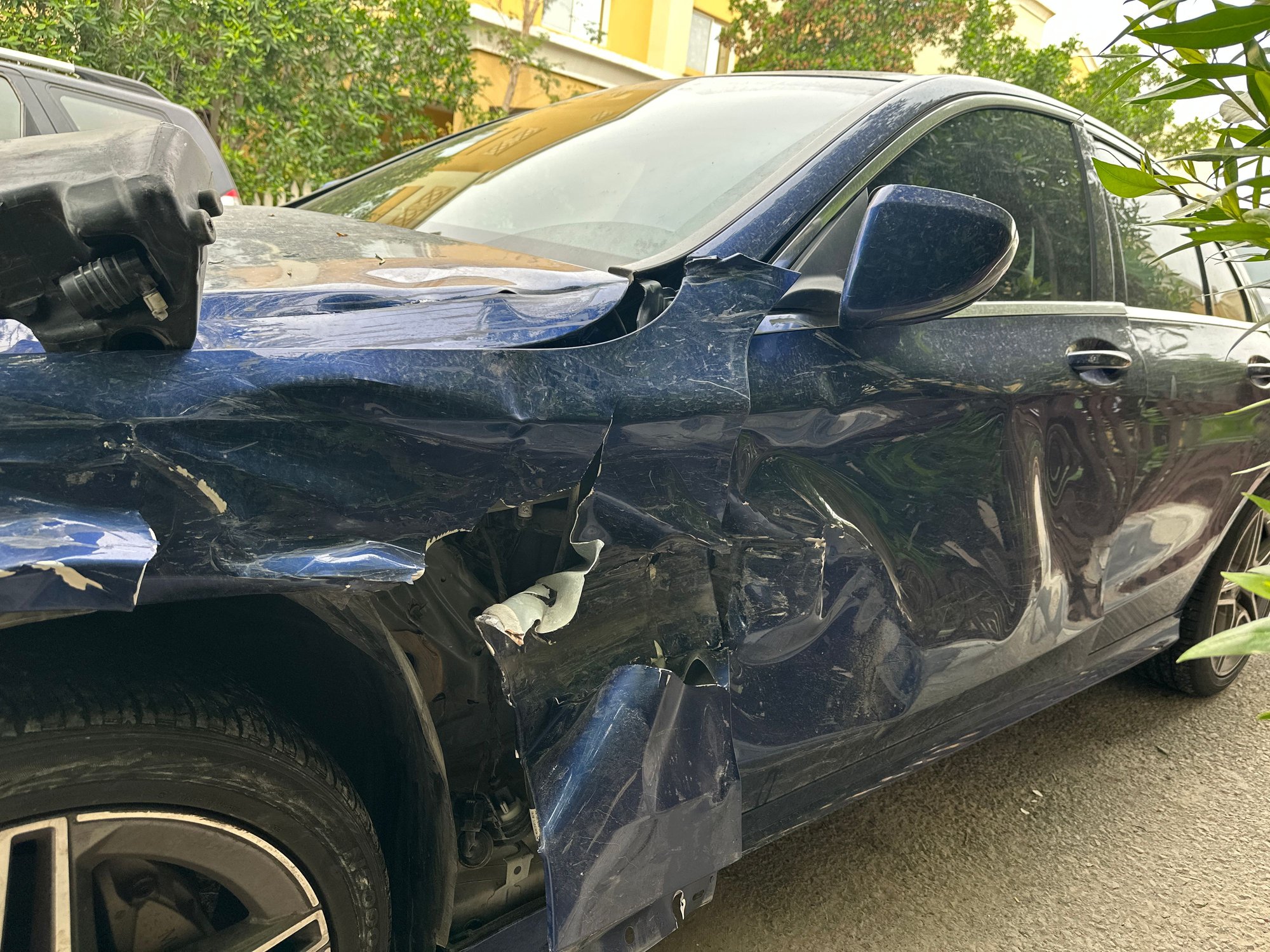

I am sorry, I am not very car knowledgeable. Do you mind explaining to me what is the thing that is torn (last 2 images) is that the chassis?
Also do you have any advice for when I go to the repair shop? I want to be as involved as possible to make sure my car returns to the way it was...

You state not being knowledgeable about cars but wanting your MB wreck repaired right.
The solution is to deal with a Mercedes approved collision center instead of a rock bottom paint shop.
side & front impacts
The unibody itself is the first and foremost important item to assess BEFORE dealing with cosmetic repairs: hood, fender and doors.
Can this car ever drive straight again? Hidden damages may be Front subframe, suspensions, steering, ... Claim adjuster may inspect damages.
With bluebook value around $17k.USD, I don't see this getting repaired.
