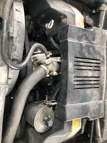

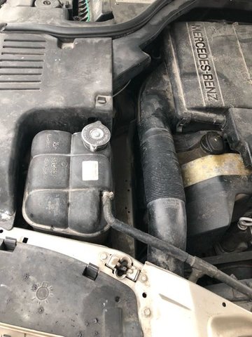

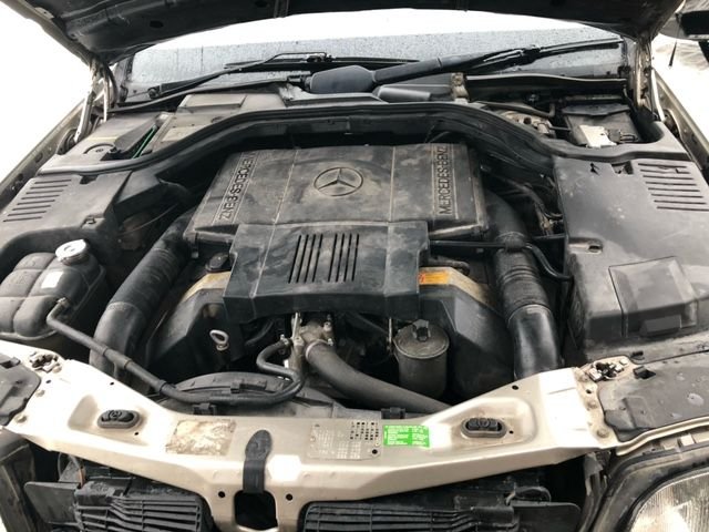

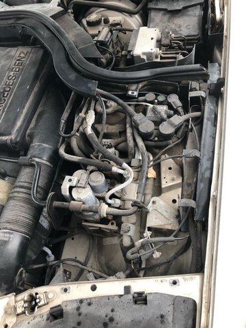

Show us a picture of your engine bay particularly on both sides.
Empty flat battery acts as a heavy SHORT-CIRCUIT. It may not charge at all.
Don't jump start your car engine now to fry your Alternator. Need charged up battery first.
Old Apr 11, 2026 | 07:39 PM
Viking87's Avatar
Joined: May 2025
Posts: 36
From: Manitoba
1995 S420
Okay will post in the am.
Knew not to start it because when I acquired the vehicle the speedometer had failed from boosting. I was able to diagnose and repair the guilty red 10 amp fuse thanks to this site. I have two batteries (one I saved form my 560SEC) so will swap it once I gain trunk access.
Will take some pictures in the morning light and add to this thread. Have never notice jumper posts in the engine bay but haven't really looked for them either. Engine has a huge plastic cover that needs to be removed before you can see anything.

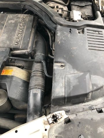

Pictures from engine bay.
Looked on passenger side and could not find any panel under the floor mats. Could you be more specific as to where it is?
Viking87

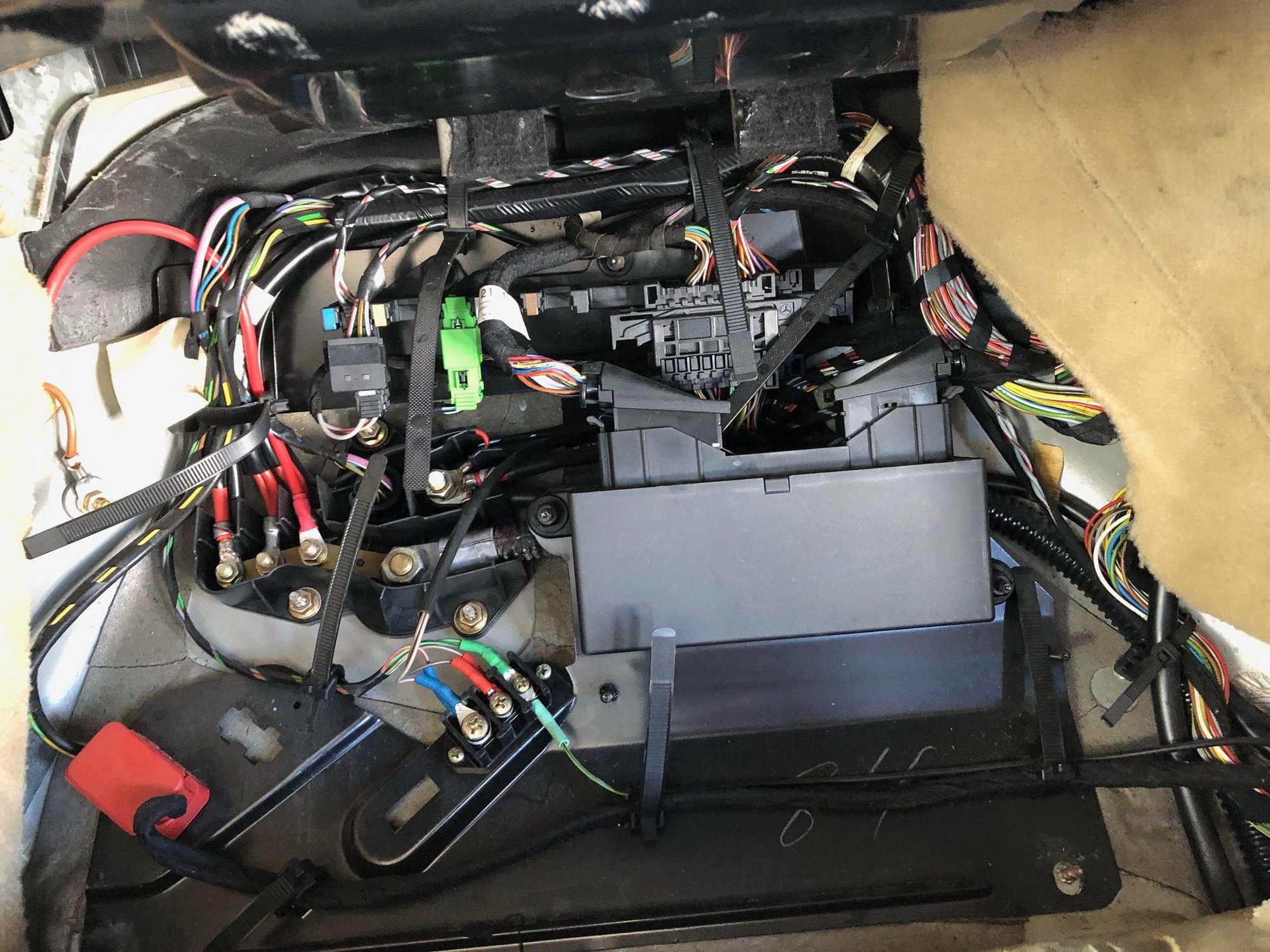

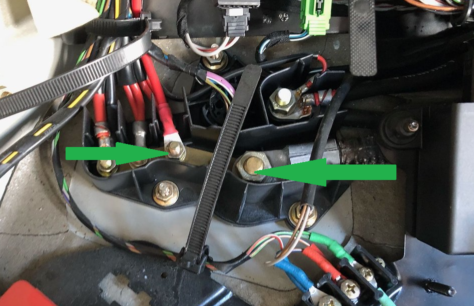

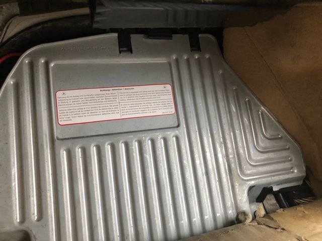

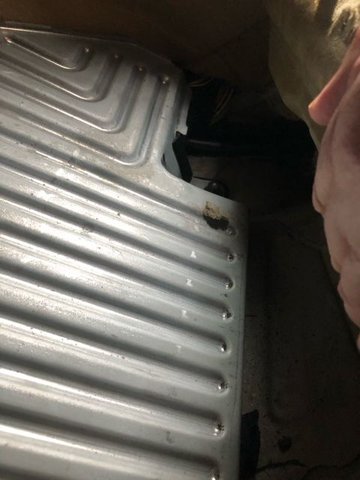

Dug deeper
This panel?
How do you open/remove the cover?

I dont have the S420 so just getting my info from searching around.

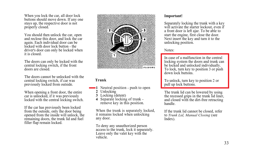

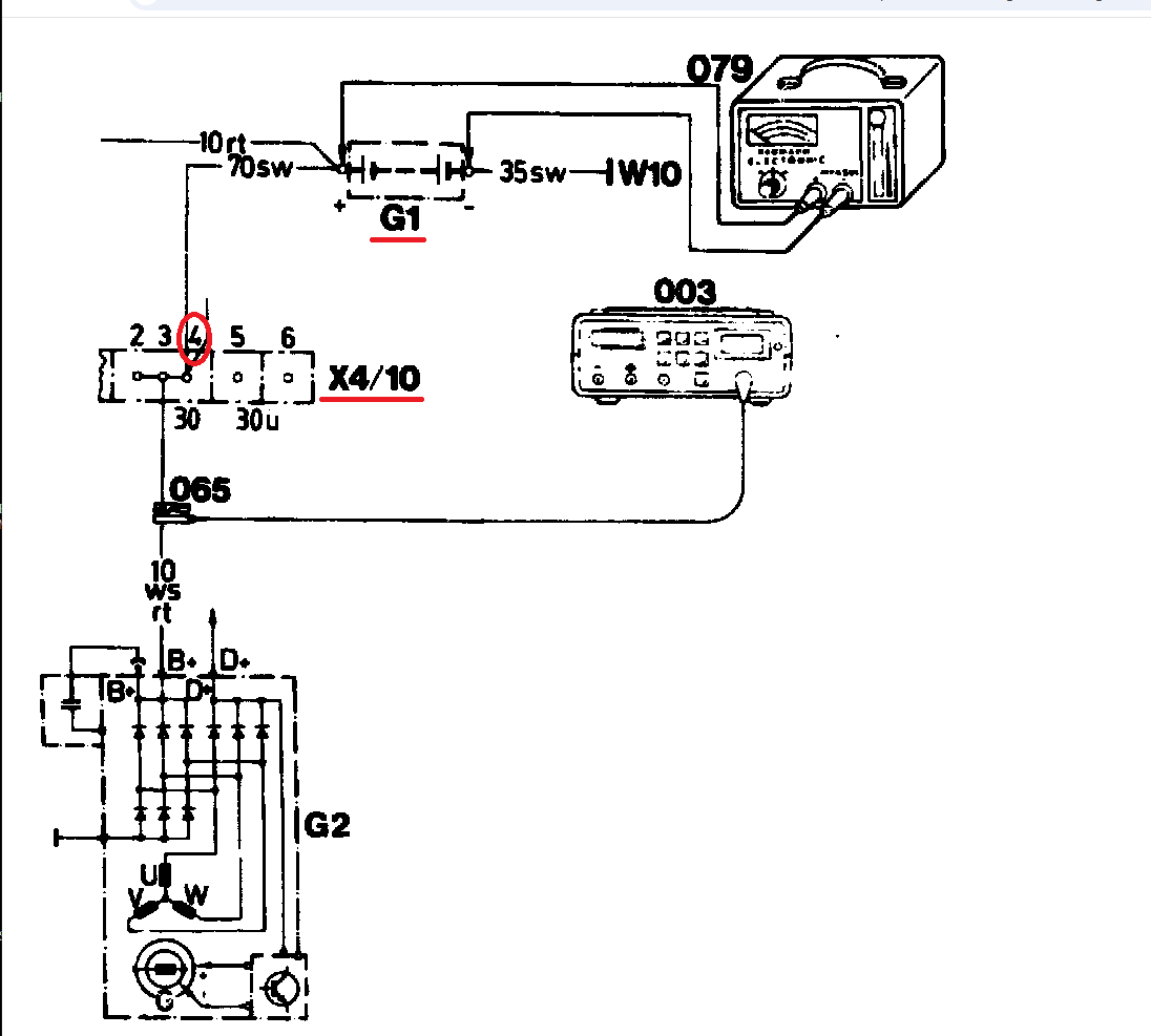

I believe i have the correct Operators manual. It says the trunk can be manually opened with the key. For jump starting it says jump right off the battery. So it should be possible to open the trunk with a dead battery.

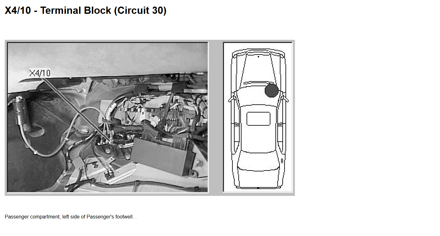

For the passenger compartment it houses the X4/10 terminal block 30/30U. When i look at the wiring diagrams this looks like a good place to jump in to since it leads to the + battery. From the photo above it looks like theres some tabs at the top of the panel, try pulling them towards you. Or look for a few bolts/screws.
I could be totally wrong.

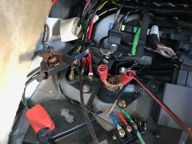

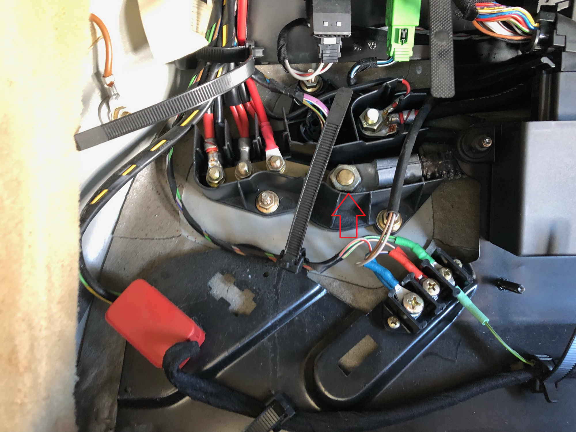

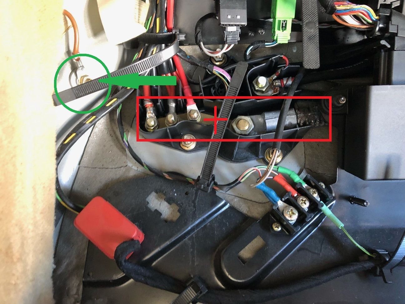

Sorry for the delay. Weather has been poor and first nice day to take a closer look.
Metal plate removed with two nuts at the base (10 mm of course).
The big red arrow (last picture) seems to have a battery cable connected to it. There (with the red positive) and seat rail (with black)? Any where closer than seat rail for ground?
My neighbor is away so will try this on my own if someone can verify.

Or here? (Green Arrow).
Don't worry haven't done either. Wanted to confirm. Green arrow has the red cable. Could the red arrow be a good place to ground?
Not going to chance it until someone who is a little more knowledgeable weighs in.

The red wires and everything connected are your positive. I would connect positive to that.
I found two ground locations in the footwell.
Old Apr 20, 2026 | 06:42 PM
TimC300's Avatar
Joined: Aug 2023
Posts: 3,788
Likes: 1,151
From: MA Coast
I think that large wire goes back to the battery. To double check take your multimeter set to continuity and test it to the two locations with the green arrows. If it beeps then connect your positive to the large nut/wire.
I just cant see if there is a bushing or something under that large wire nut separating it from the red wires. They look all connected on the metal bar underneath.

I'll add usually a brown wire is ground especially when its bolted down to the frame.

Success!
Thanks Tim
