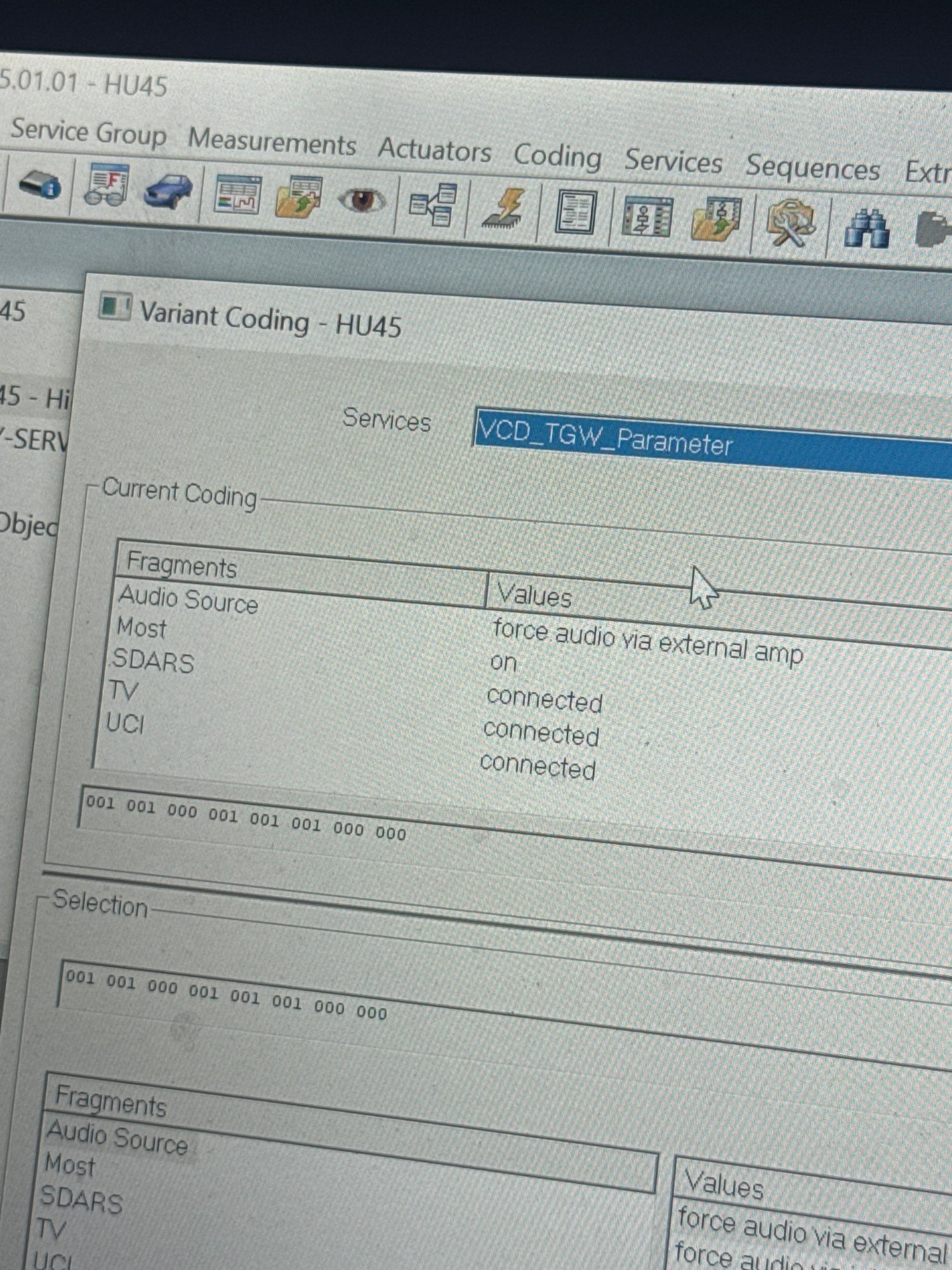

Vediamo shows connected
Xentry sees it, knows its supposed to be there
Xentry sees it, knows it's supposed to be there

1 - In Automotive, the MOST Bus it's just for Audio and some Data ( volume up/down, DSP, SW updates), no Video signals.
2 - As you can read on interface web "Mr12volt uses the MOST optical system and utilizes "TV" video input" - they use "and".
So, the Interface will create a fake flag as a TV, but it will not act as a TV.
In the Schematic, the Video is routed directly to the Car Display. So when you press something...I do not read the entire Instructions - the Interface will cut the Video Signal from HU to Display and the Display will remain connected only to the Interface.
Anyway, the TV menu in the HU may not act as a TV,
Here is a coding from a JP HU4.5, you may try different Options for TV - if there is available under "connected"
