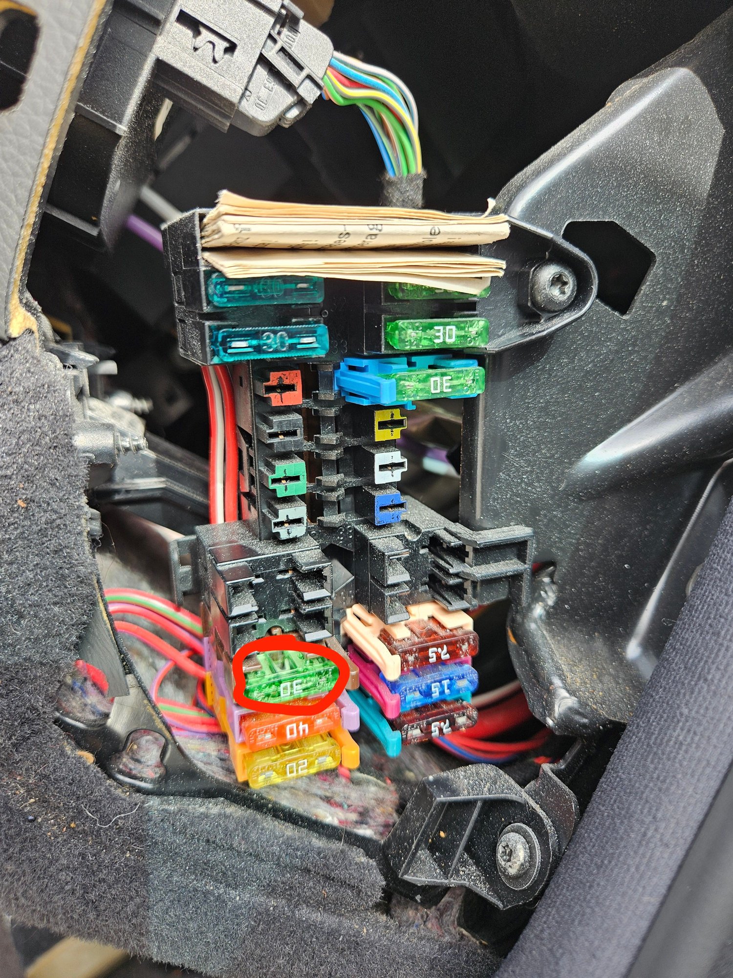

Hoping someone can help me diagnose a problem with my W209 CLK500. Whenever I start the car in the morning, the steering wheel adjustment lever & drivers seat adjustments do not work. However, if I remove fuse 29 (circled in red below), then re-insert it, everything starts working again. What could be causing this? i've tried replacing the fuse itself with a new one, but that is not the issue. thanks.
CLK500 Fuse box
CLK500 Fuse box
