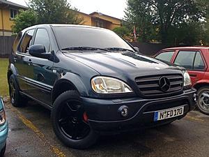

no rack...
waiting for my roof caps so i have them coverd with 3m rockguard to keep the water out till then..
