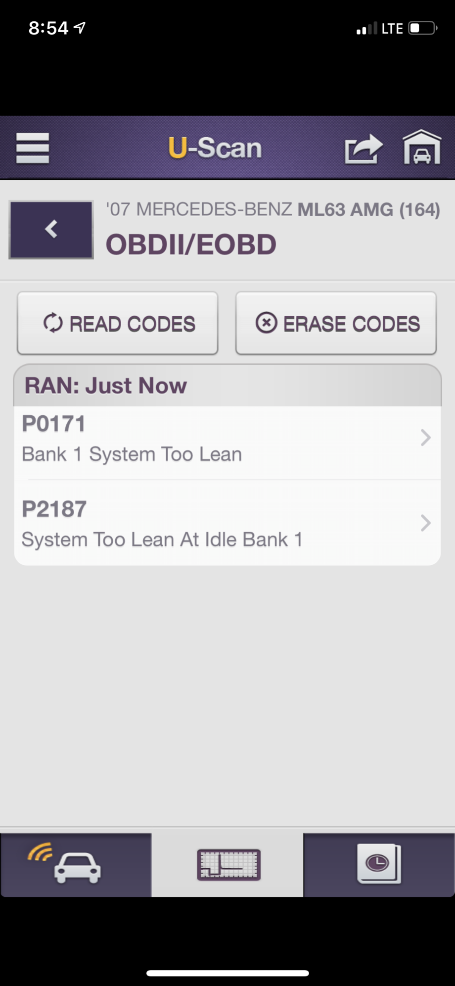

CEL on, p0171 p2187
Chasing down check engine light... come to find out, intake manifold is bad after only 60,000 miles. Magnesium corrodes pretty fast, the part should have been made from aluminum to begin with. Pics are of error codes, fuel trims and intake manifold corrosion
