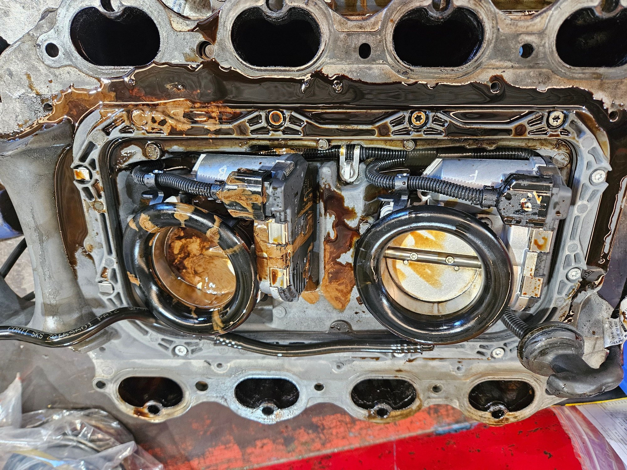

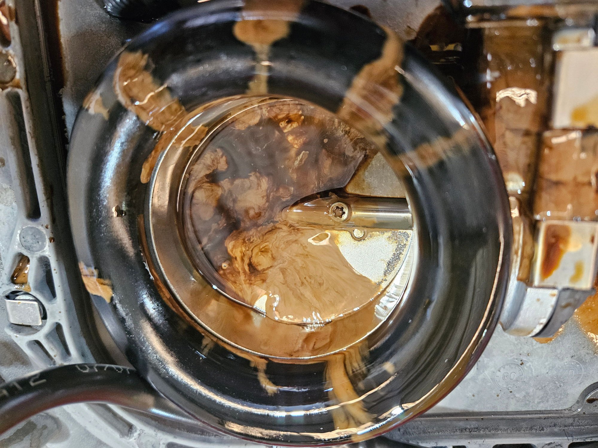

Also, I disassembled the intake manifold and cleaned it thoroughly before re-fitting it. After I removed it the second time I found oil with water contamination in the exit of the new PCV valve I fitted. I think that's odd too, and assume that the crankcase is seeing too much pressure?

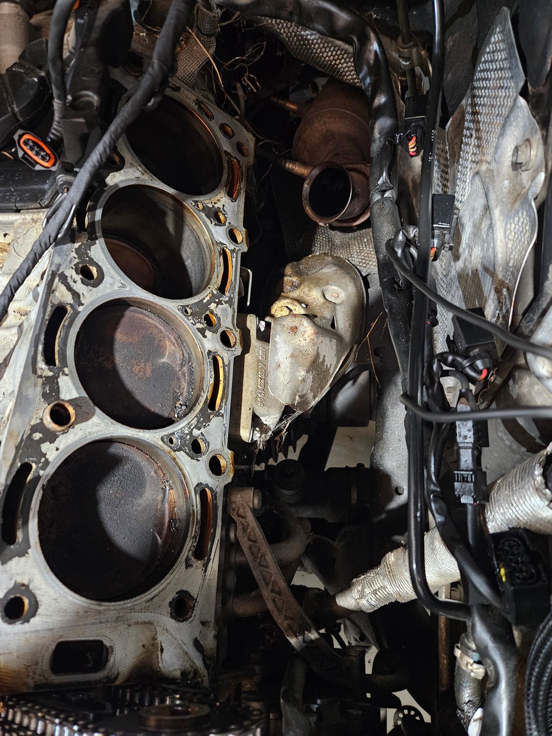

Pulled that head off and there's no sign of a breach in the gasket, and the head is straight. The deck is straight too. Took this head to the same head specialist friend, checked the head for straightness (good), hardness (good), and vacuum tested it after cleaning the valves. All good again. Again bought an OEM Mercedes head gasket, new bolts, and re-fitted the head, ran the car up, and within a couple of minutes had water in my oil and oil in my coolant.

Just an FYI, I also dismantled and cleaned the intake plenum, and rebuilt the cam adjusters (phasers), and polished the cams, which are in good nick.Also replaced all lifters (buckets) with new. Loats of money has already gone into this beast, and even more time. Huge amounts of time.

If you put pressure on the cooling system, you can send a boroscope into the cylinders and see if you can see water dripping down the cylinder wall. Otherwise, have you checked al other areas where water and oil can mix such as an oil cooler/seal? Im not too familiar with the m156 engine, but these are some of the first things to do when suspecting a failed gasket in the head. Since we cant see all of the pistons in your pic, are any of them "washed/steam cleaned" from water intrusion?

There were no differences between the condition of the tops of the pistons.

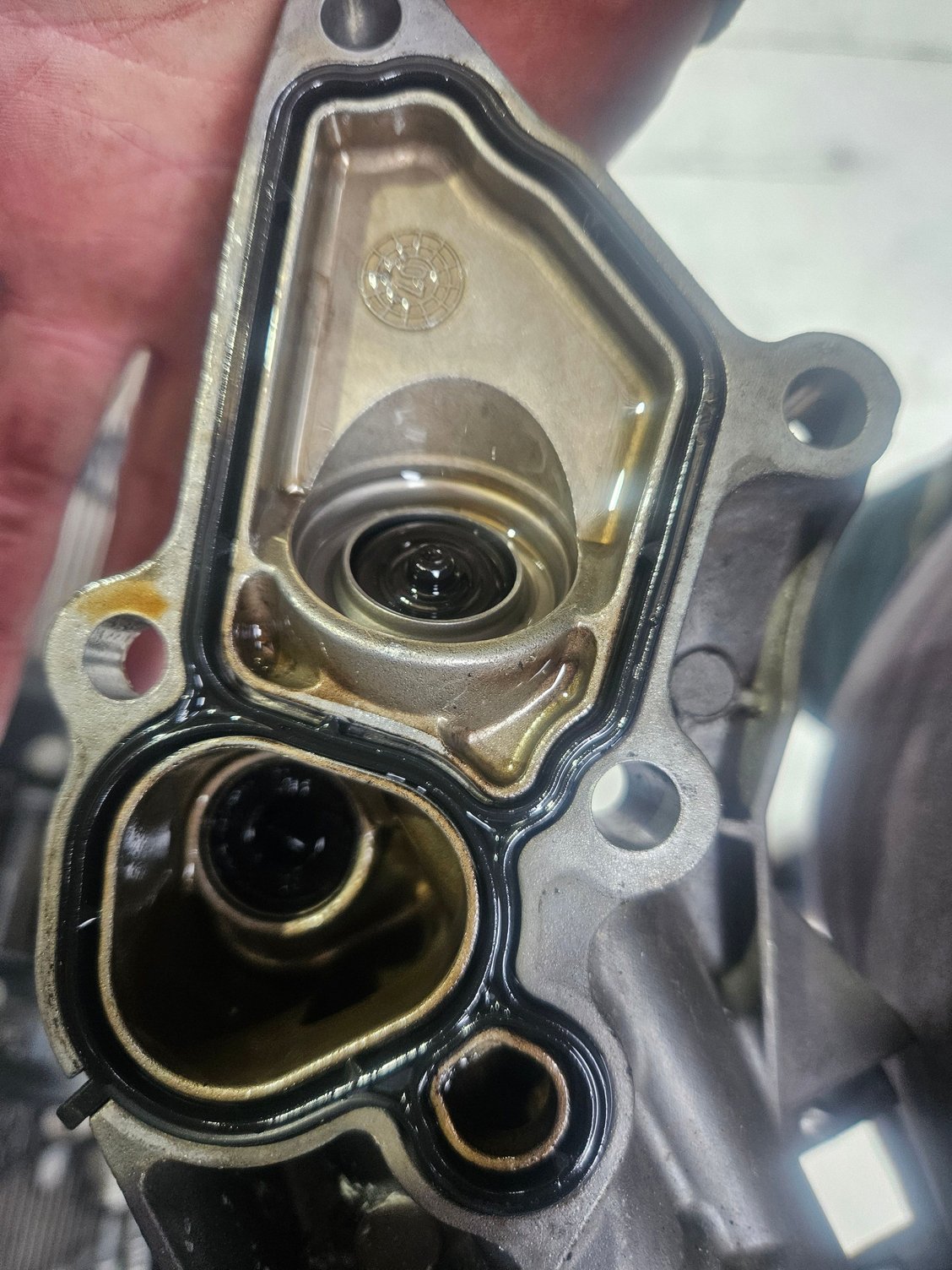

Only other thing I can think of that's External to the block is the oil filter housing. Coolant flows through there as well but the gasket has to have a major fail or was not included to get the same results you're getting
If the leak was at any of the attachment points externally a preasure test and some soapy water would highlight it pretty quickly. But if the engine is already apart for the thermostat and water pump, getting the filter housing off would be pretty easy

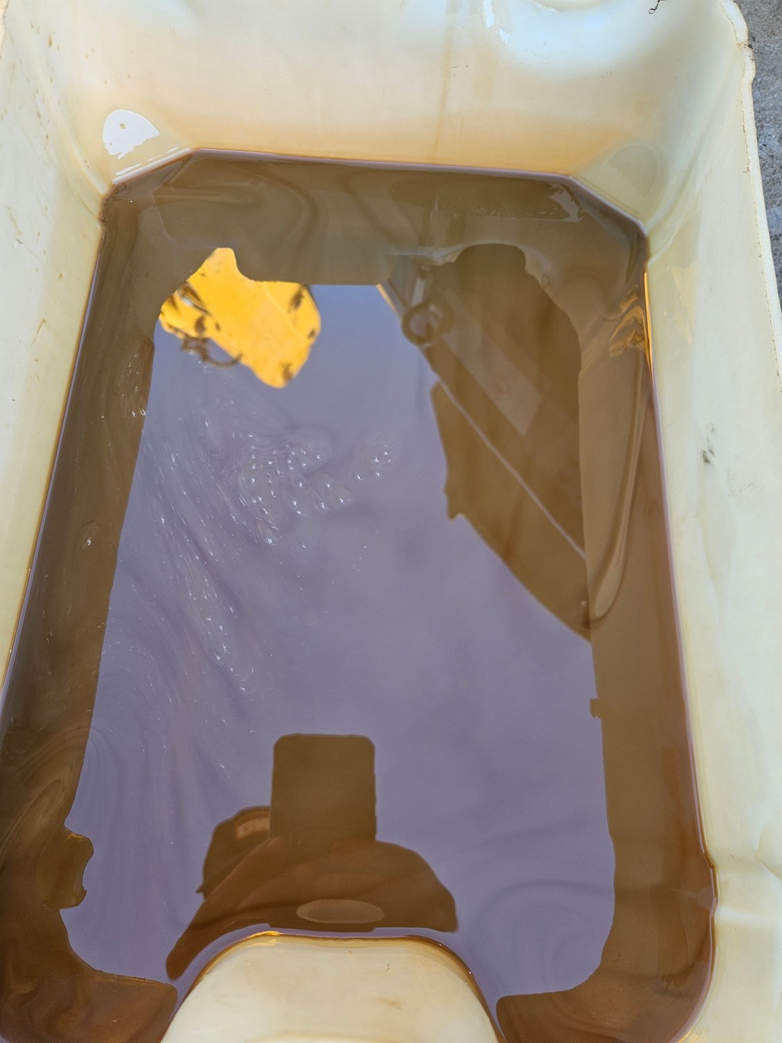

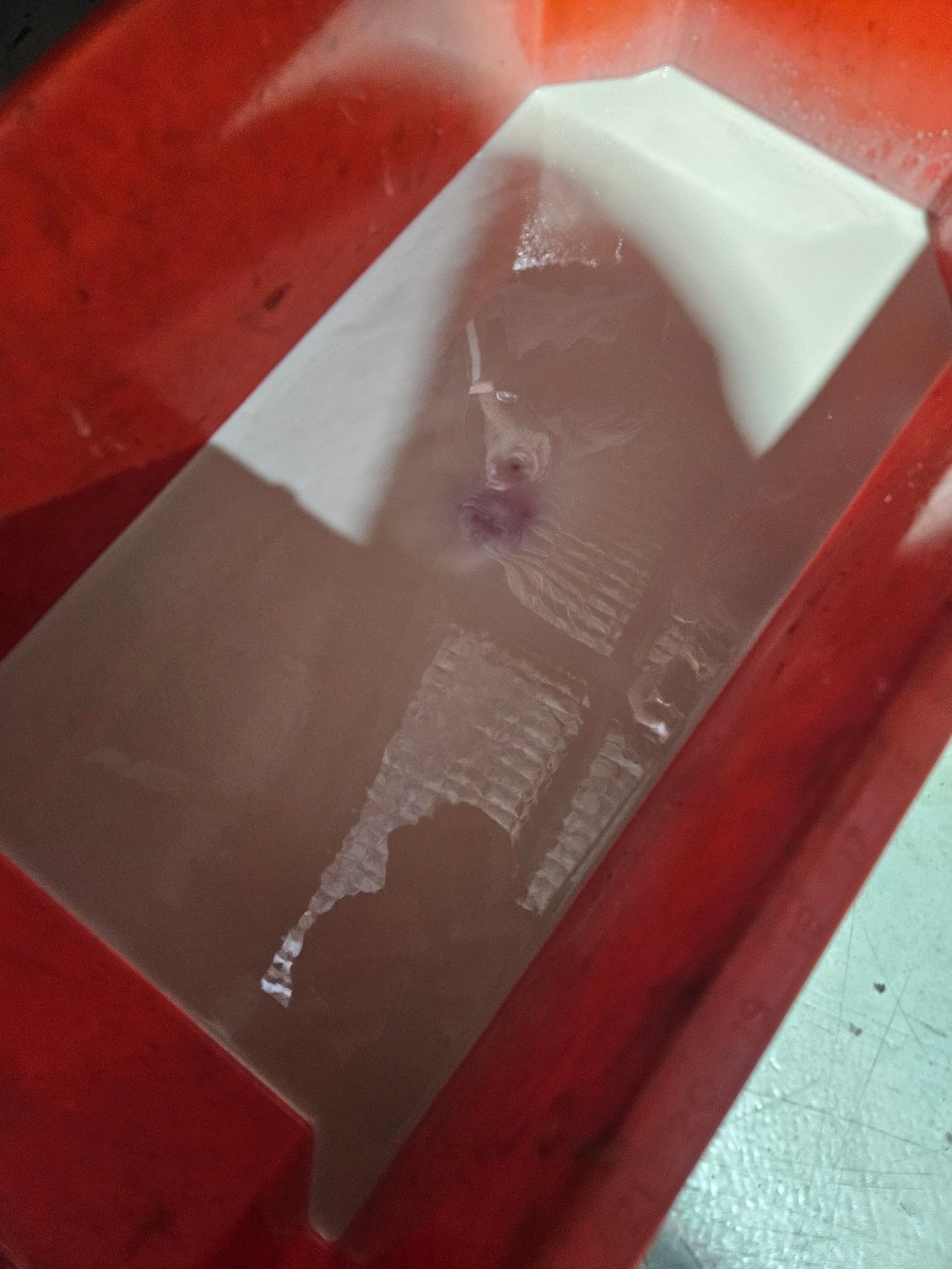

Well that was a false hope. The product that we used stopped water getting into the oil, but oil is still getting into the water (coolant).
Is this correct? If so, why? Seems like an odd design choice!

Here's the oil filter housing. There is no coolant gallery. Only oil.
