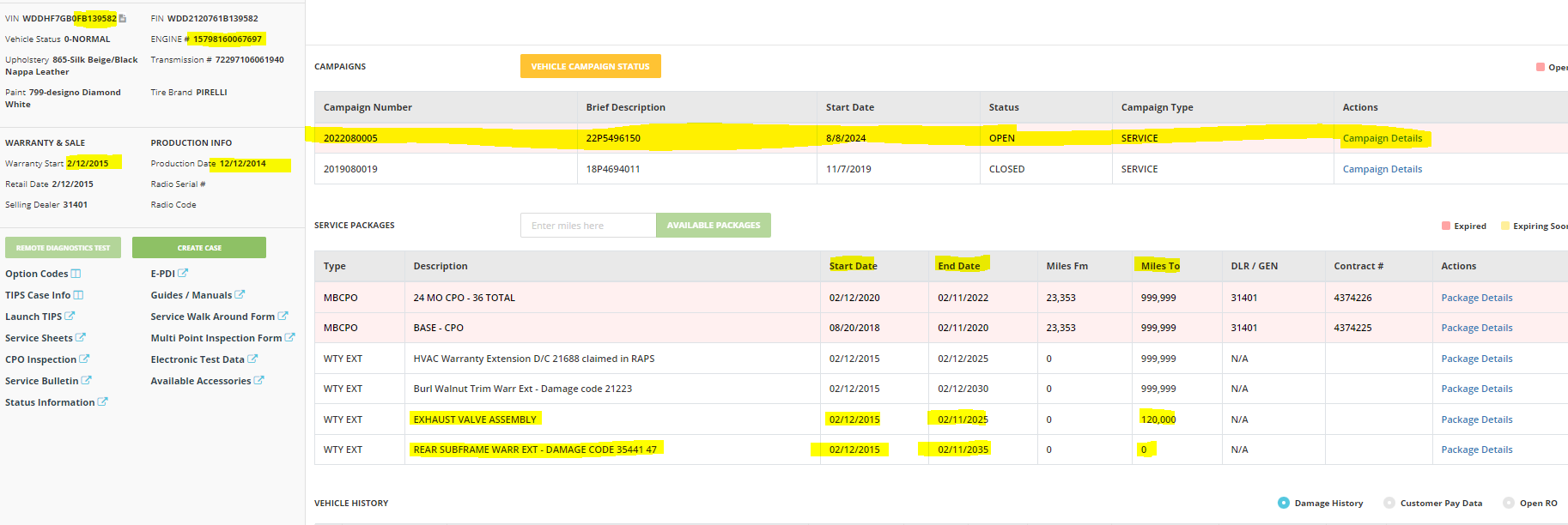

Send me your vin # and ill check to see if your vehicle has the extended coverage on the valves. The warranty is based on sell month of the vehicle, mine would be the end of March 2025 being a model year 2015, rr mileage up to 120,000k.
hopefully its not a canada based vehicle.

My vin# is WDDHF7GB0FB139582. It’s a 2015 E63S sedan, shows manufacture date of 12/14 per door sticker. It has 58k miles, US origin. I am thinking/HOPING it qualifies, however I think it may expire in December…?
THANK YOU

hopefully this attached your VMI. Looks like you do have the coverage so I'd set up an appt with a dealership you have some connection with or not. Talk with the service advisor regarding your results. Dealership will have to redo the testing to verify but i'm not sure what they will charge. This warranty doesn't exactly cover everything. I had to pay for intake valves since Mercedes will not.
I think Code P030085 needs to be present as a fault. (combustion misfiring is present on mutliple cylinders)
You also have an open service campaign for ECU update Emission Service Campaign 2022080005 Launch Notification Perform Engine Control Unit Software Update

Thanks again! Good to know I have until Feb ‘25…I don’t have the codes active since I cleared them last occurrence before learning of the extended warranty.
Bummer re intake valve costing, thought that was covered. Still, significant coverage to resolve a 70% leaky cylinder is something. Of course it’s sad that it occurs at all in a 60k mi motor from a $100k+ vehicle.

Couldn't have said it any better. I dont believe Mercedes has changed the part numbers on these heads so this issue will not be going anywhere.
If this was a customer pay job, I think it would be best to take the heads to a machine shop and see if upgraded valve seats can be done.
yeah I tried to argue with my Warranty Admin that I shouldn't have to pay for intake valves but i didn't get very far with her lol.
Hopefully you can get those codes to pop back up & crossing my fingas that it all goes well before you run out of Warranty

Reviewed the warranty doc again, as I thought for sure I saw Intake valve coverage. It seems I did, but maybe only the labor portion is covered?! That makes zero sense to me, but I see it under damage codes but not parts codes. I wonder if @TECHNICIAN might chime in, or any others that have directly worked for MB dealerships
