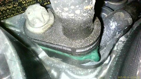

My wp has a slow coolant leak I was told it was replaced in Oct 2022 so I'm surprised it's leaking so soon (only covered 12k miles in that time).

Here are some pictures of the leak.

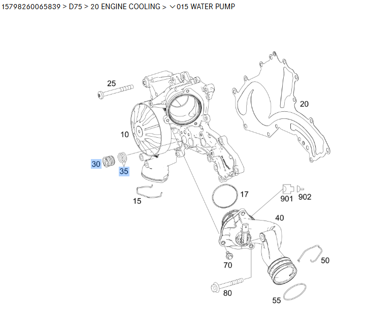

I see the part number on the pulley like you said, I see why you thought that for sure. Looking at the parts catalog there's a "water pump cover x2" that will not come with a new assy. #30 is a qty of 2, will not come with the pump, #35 is a qty 4 and will come on it, not sure if 2 of these are used to block off ports depending on the model? Possible that one of these having a failing O-ring? Part numbers are 278-201-01-03 x2 027-997-06-45 x4 O-Ring.

Thanks, yes it is possible one of these o-rings has failed rather than the wp. I'll investigate further.

Water pump was leaking, replaced with an aftermarket part (GRAF). Also replaced all idlers (FEBI), belt tensioner (Gates) and belt (Genuine). Thankfully tstat and coolant lines did not break, are only a few years old.
