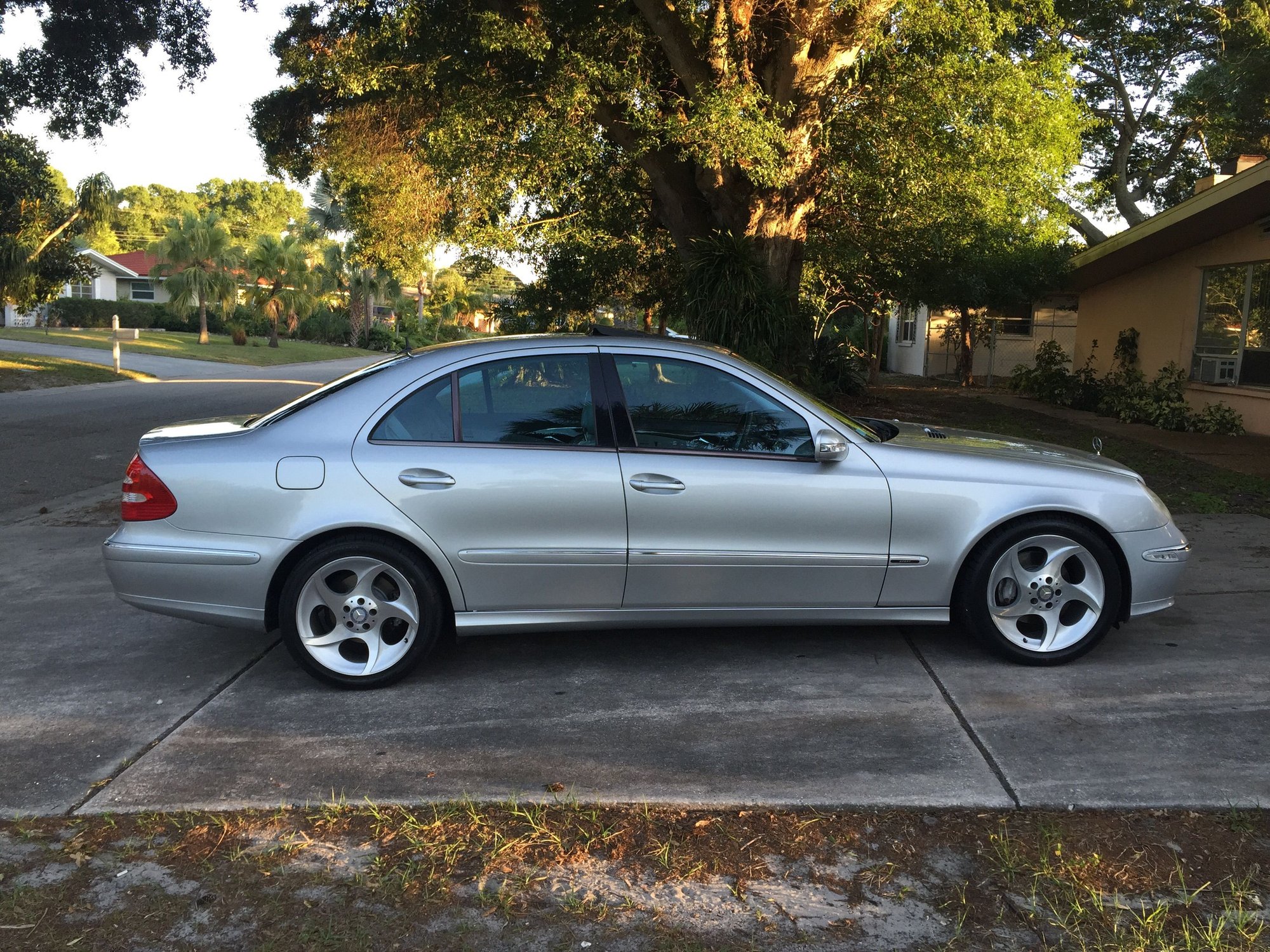

I just wanna add pic's of my e500
My car sits on turbine wheels from an 06 sl500 since i havent seen one like that online i figured ill add some pics in case someone was wondering what their car would look like<br/>Thanks

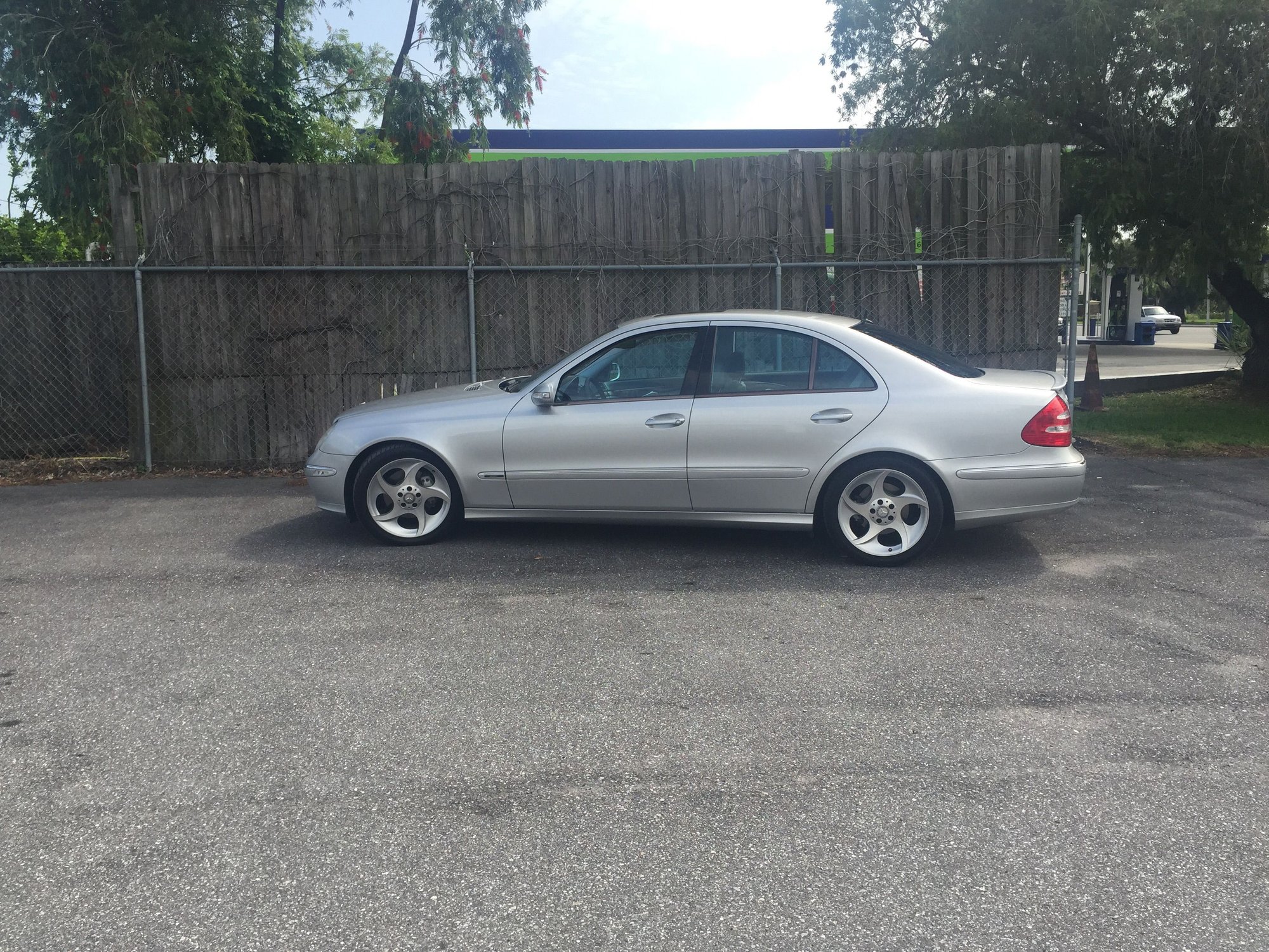

Hello again
I figured ill go more into detail of what i did to it
Wheels are: 285/40/18 in the back
255/40/18 in front
I also lowered my front by an inch by adding washers
I have no problem with rubbing when turning
But by lowering it that way my camber is off
I put 3k miles so far and i cant tell the wear on the inner side of the tire so far.
By what i can tell:
If you will want to install 19" wheels you will have to drop to a lower profile tire otherwise the tire will hit the upper balljoint
Right now i can get my finger between the tire and the upper balljoint so keep that in mind
Thanks and i hope you enjoy

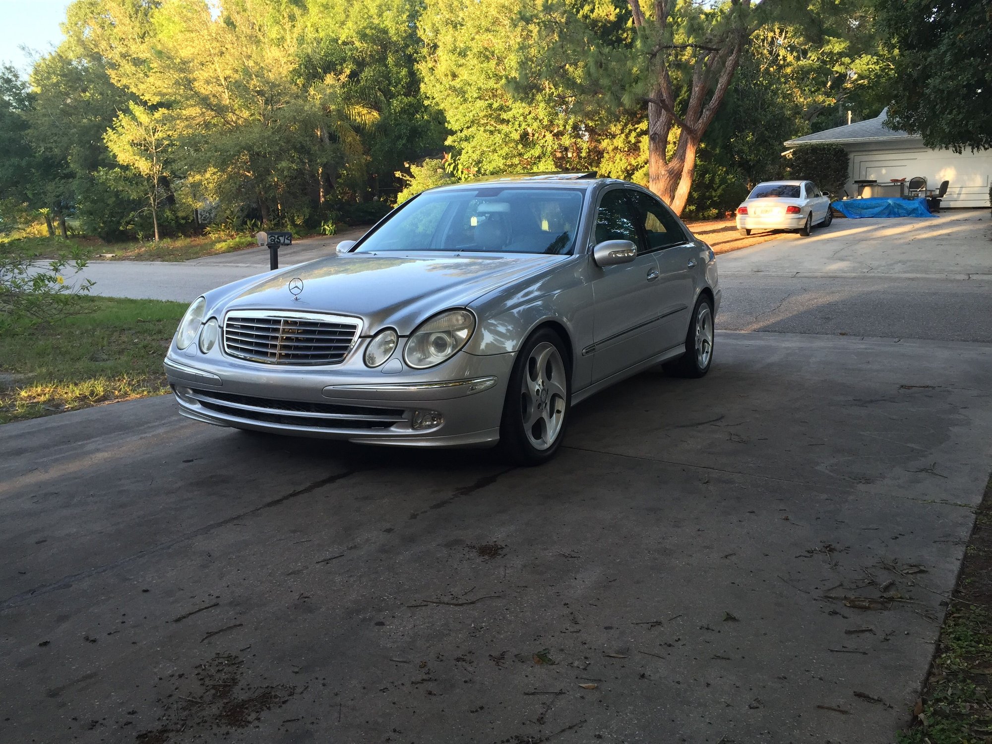

Sorry the front tires are:
255/45/18
I aslo put zimmerman rotore and akebono pads
After a month of driving my wheels look as clean as they were when cleaned
No more cleaning wheels every 3 days from brake dust
