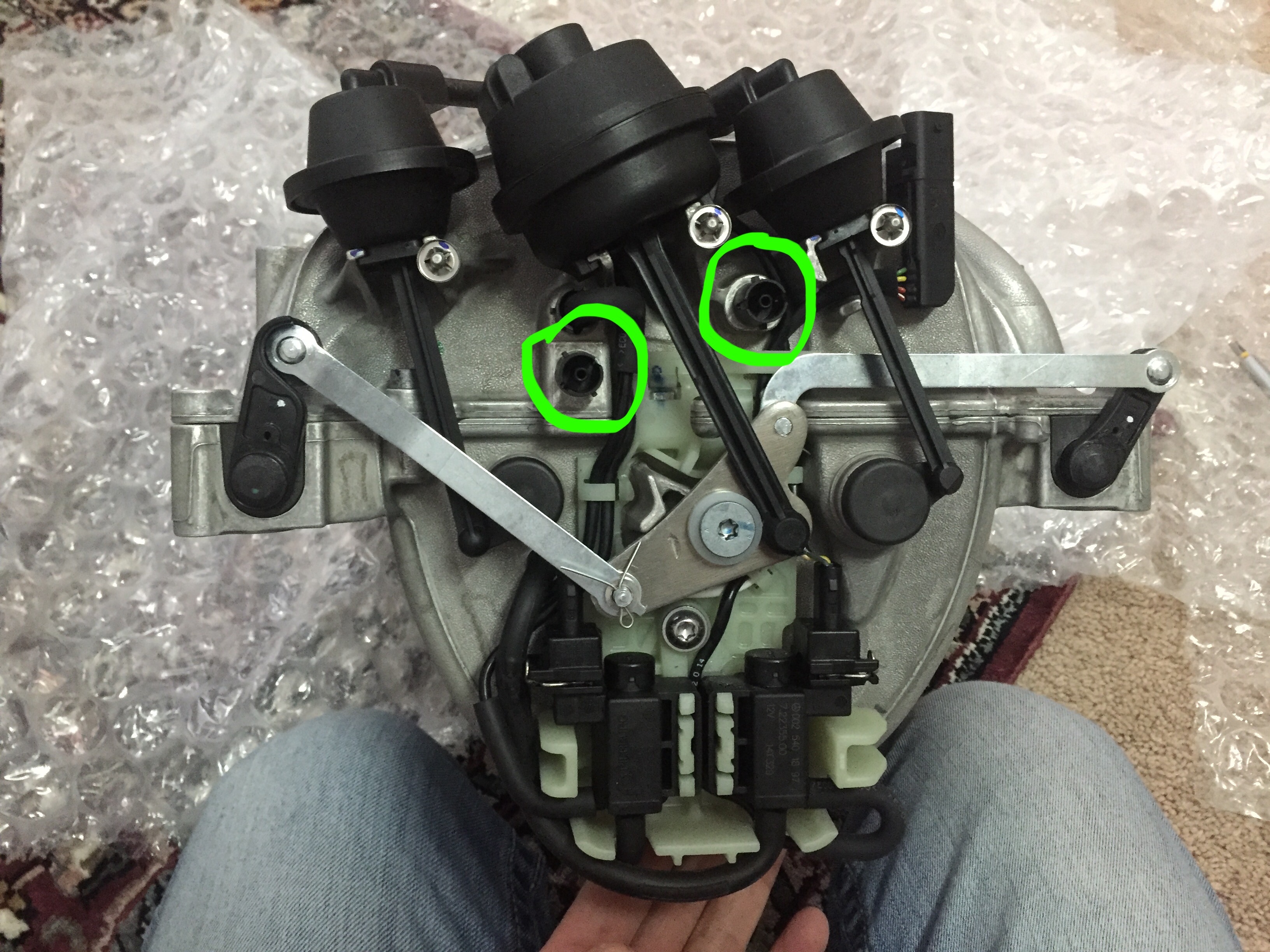

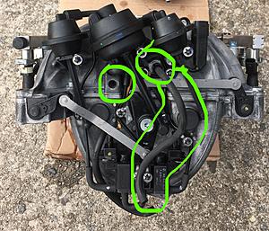

The engine has been cleaned as best as I could and nearly all new parts have been installed except for the partial load hose. I'm ready to drop in the new manifold, however, I don't know what goes into the two manifold connections. The old manifold had a hose about 6" connected to it but I don't know what it was connected to. The new manifold just has the connections. Correct me if I'm wrong, but the hose from the air change over valve is connected to the left connection on the manifold (if looking at it). So that leaves the right connection......can someone please identify.
