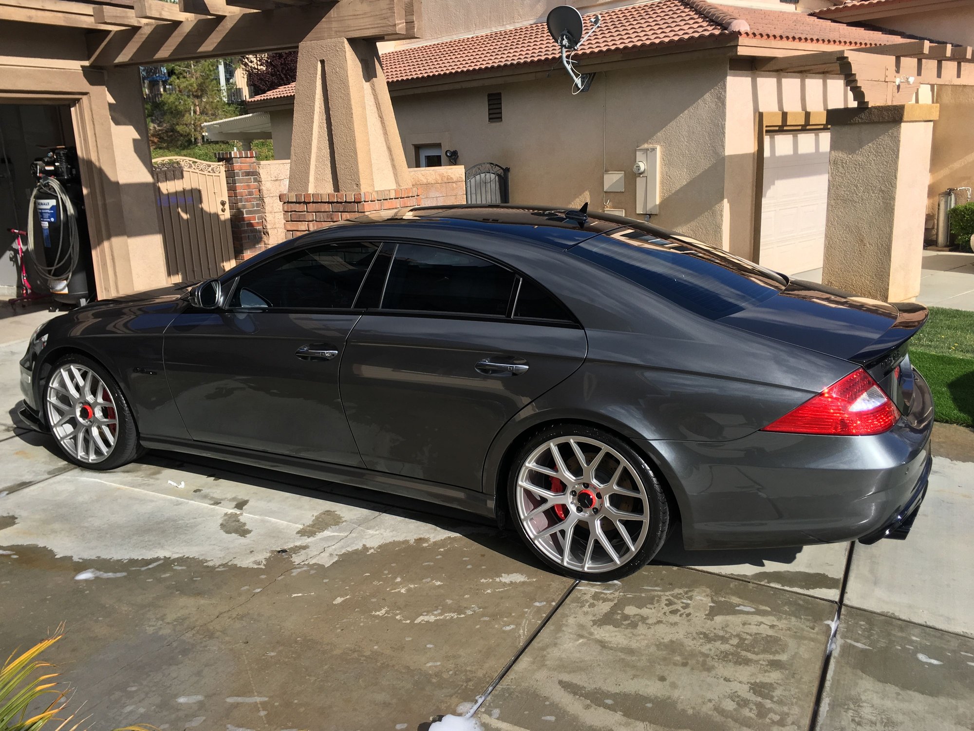

Welcome please post picture of your ride

Beautiful looking ride
