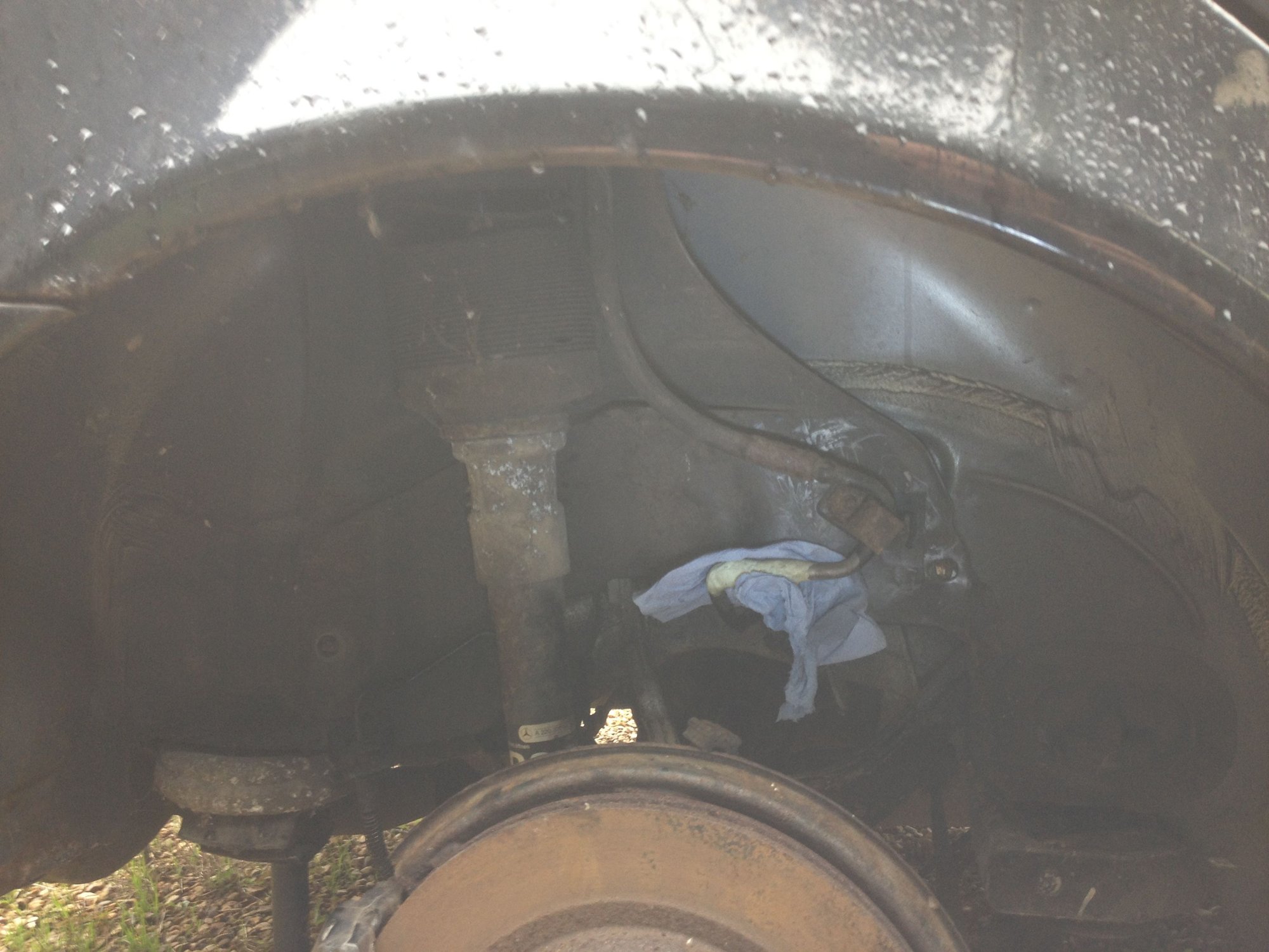

Hello all . . .

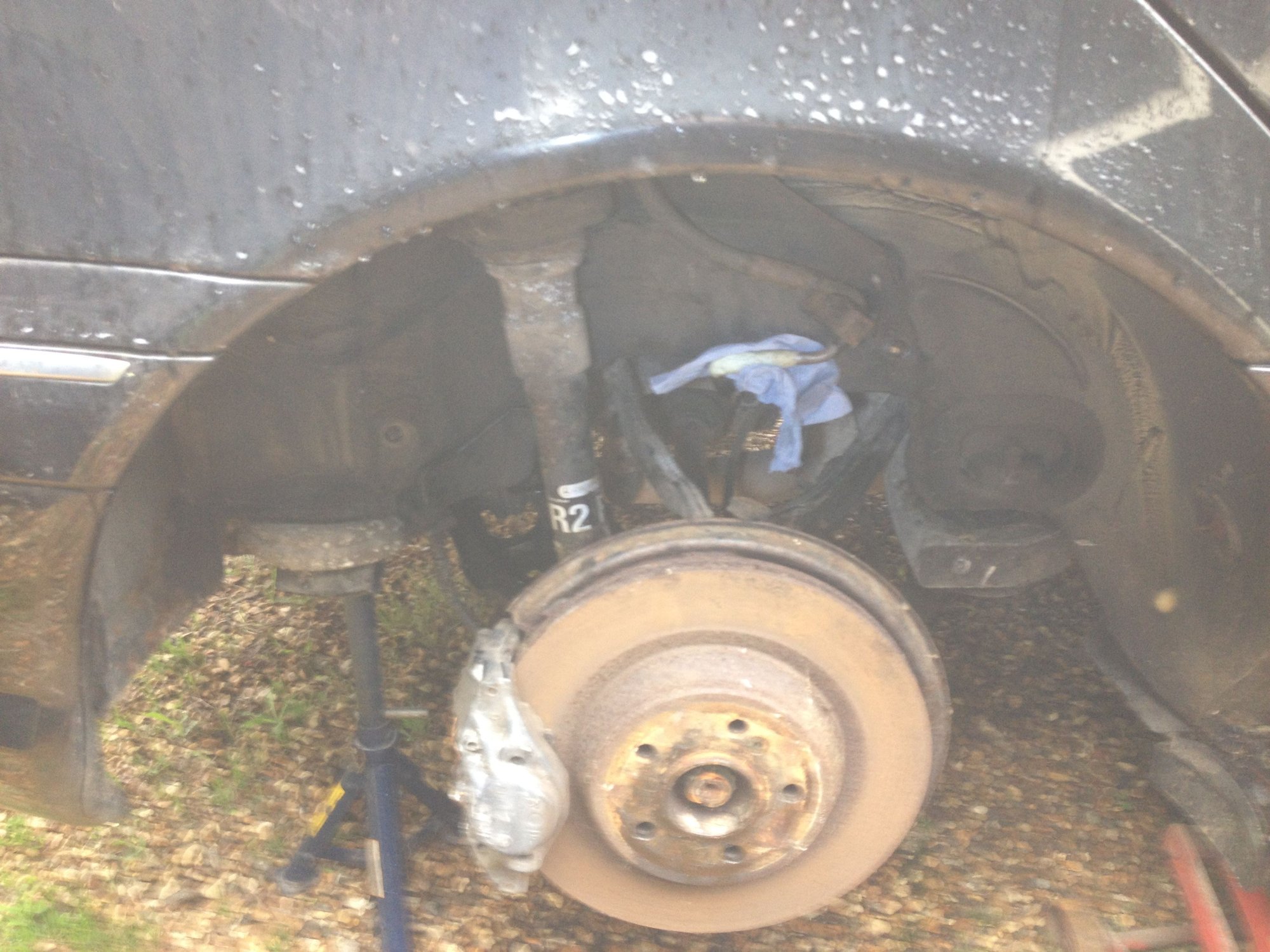

First time on a car forum, and first time i've ever owned/purchased a Merc :-) Have recently bought myself a 2001 S600 with the ABC system, and wondered if i were to add a picture on here, if anyone would be kind enough to possibly recognize which pipe it is that i have leaking, as i will need to replace it :-( I have been doing quite a lot of searching on the internet, and come across quite a few good diagrams . . . but can't seem to get any part number to go and get one ?!! A couple of garages and hydraulic pipe makers here on the I-O-W where i live, say they could probably match it up (or repair/copy one) if i remove it and take it in as they can't be sure with the photos i supplied them with.
The only issue i have with that is what pressure will there be in the system for me to try and take it off to get it looked at ?!! Do i just need to have all Four wheels in the air to take weight/pressure from suspension struts! I will attach a couple of pictures i quickly took on my phone the other Day before it started pouring down. It is the back of the pipe that has corroded/become porous, and i did try "liquid metal" or something similar, whilst the wheel was jacked up, in the hope that the pressure would be eased off enough for it to "take" ?! I gave it a good blast of brake/carb cleaner immediately before applying it, and it only slightly weeps when car lowered, but just want to fit a new pipe :-)
Sorry for boring "waffle" Bob. (pics seem very big ??!!!)

Pretty sure that line runs across the rear of the car and to the valve block on the left side.
There's plenty of diagrams here, i'll try to find one for you.
