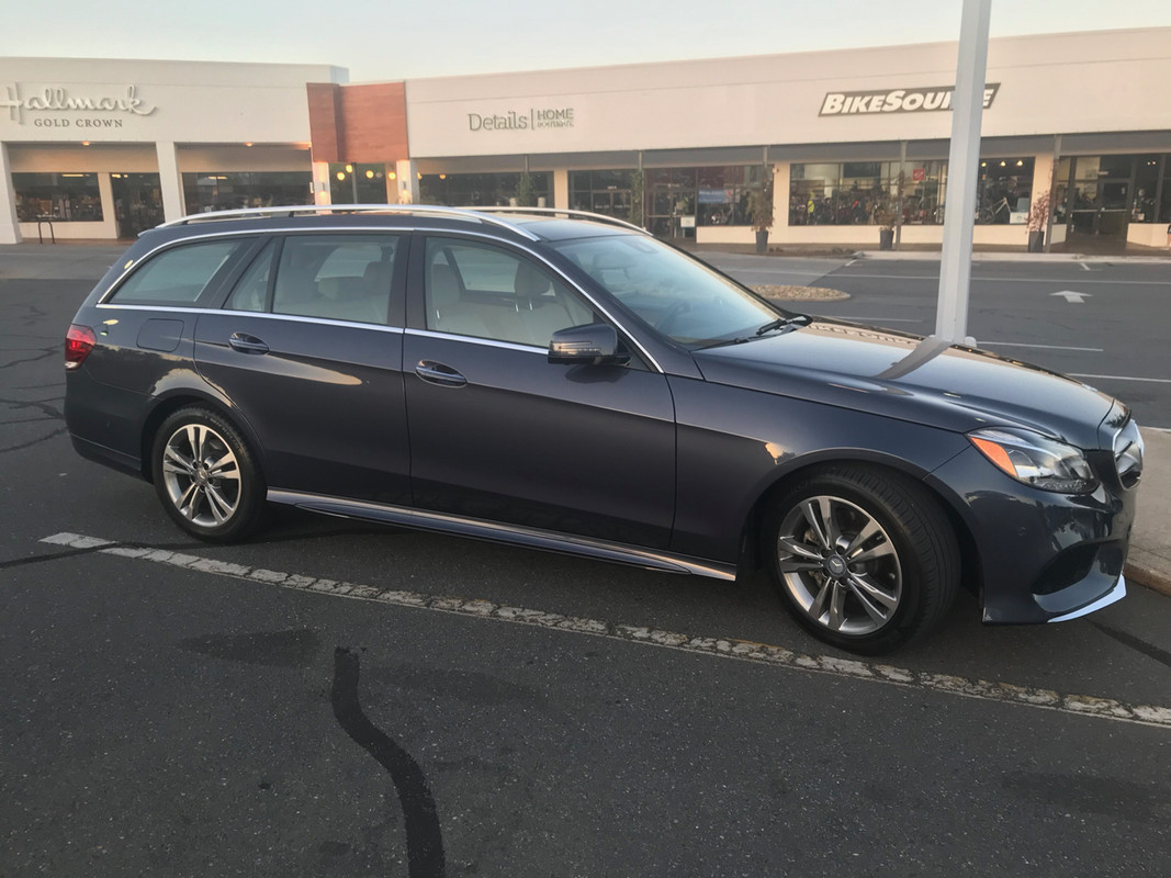

Well, I knew I would eventually up here and now is the time! I'm BMW guy thru and thru but last spring my wife bought her 'dream car'...a Mercedes Wagon. She got a very respectable CPO deal on a 2015 W212 Wagon with 21k mi. She drives a LOT hauling the oldest kid to swim practice umpteen times a week. She's logged 9k mi in the first 6 months.
First oil change came due and I told her that I could do it, or she could take it in. Ultimately, I think the convenience factor won out and I ended up underneath the e350 for the first time.
