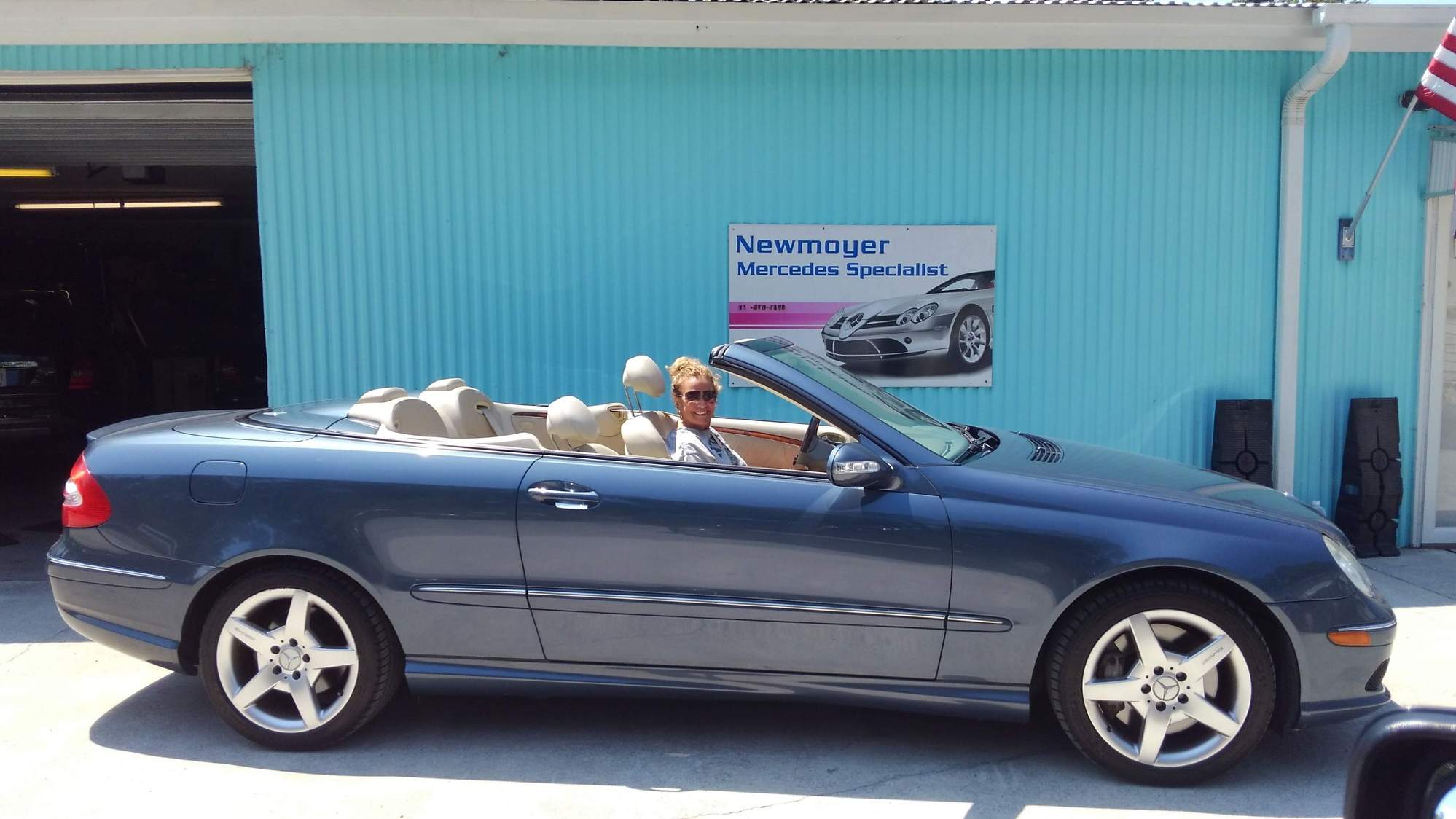

Hello MBWorld. I have just joined because I have just become an owner. I bought a 2005 CLK500 Cabriolet/Convertible. I took a leap and bought it sight-unseen from a broker in Florida and had it shipped to NC. It has 58k miles on it. This picture is just after we got it inspected after it arrived. We drove it to NJ the next day over the July 4th weekend. It is a wonderful car to drive. I don't know much about it's maintenance history other than it was maintained at a Mercedes Benz dealership in Naples, FLA. It has a few issues that need to be worked out. I plan to do the maintenance and repairs on it and post my efforts so that any other owners can see what's going on - and so that I can get help with the work, which I'm sure I'll need!

Congratulations and welcome! Looks great.
