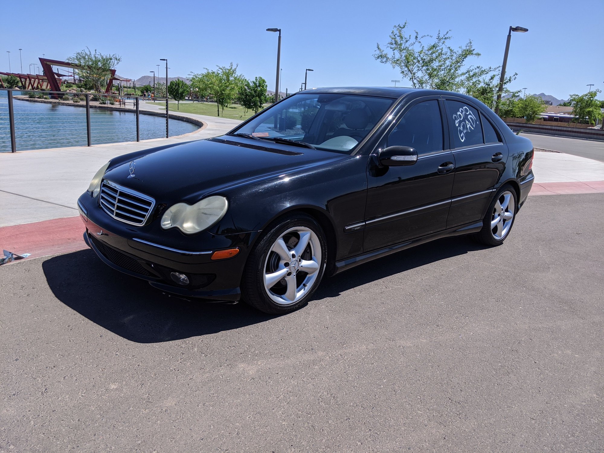

Before we brought the headlights back to life
Evening drive and getting the feel of his new car
Loving his new Benz.. and after the headlights have been brought back to life... TurtleWax headlight cleaner... Worked great... Easy to use...
