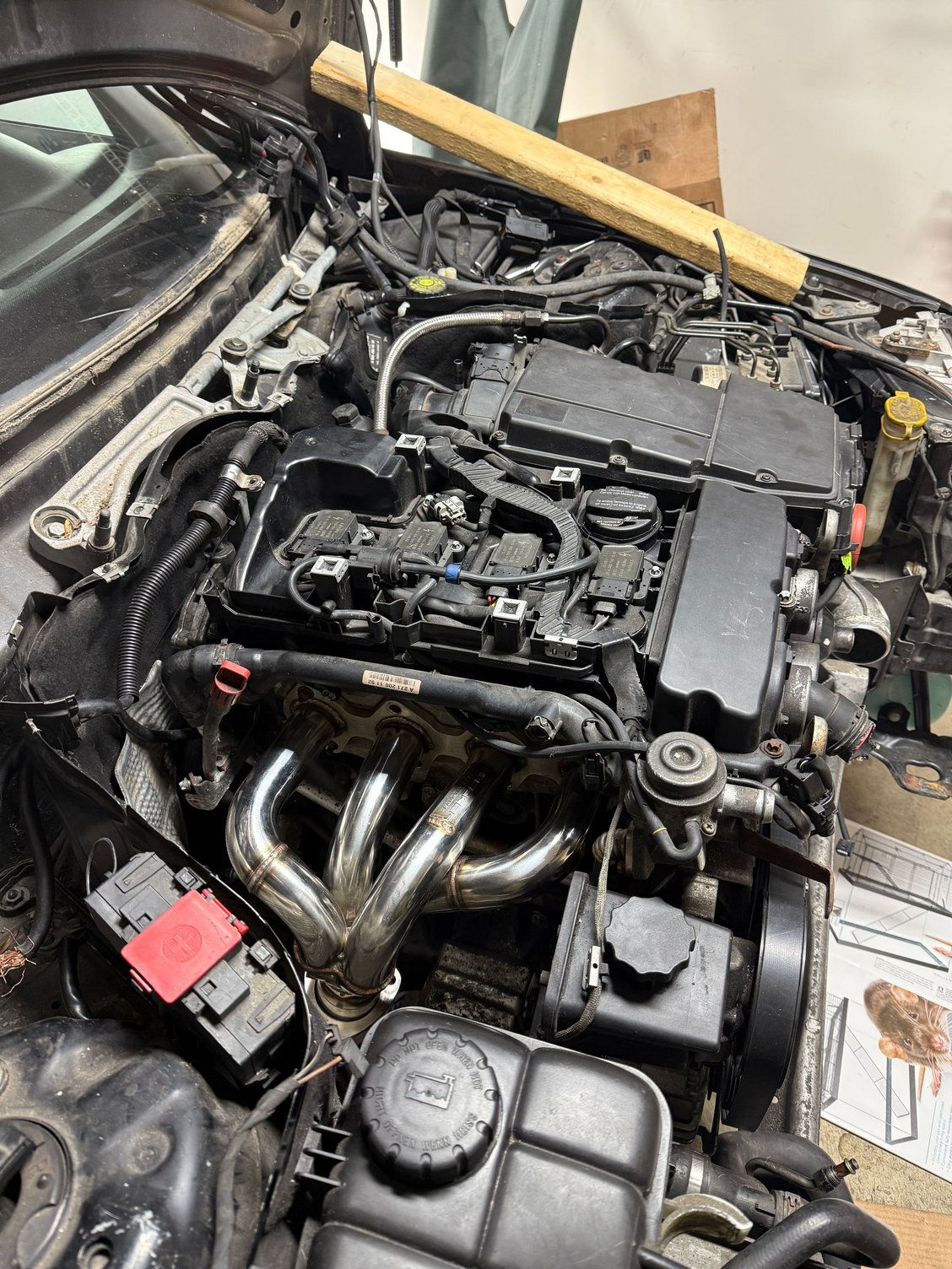

Not new to the forum however I am a new member. Lots of knowledge on this site so I thought it was time to show off my build,
my headaches, and my victories with it so far..
hoping this will help others where I’ve struggled and maybe even help me with the build.

mostly stock with the exception of a magnaflow cat back, and a POS junkyard welded downpipe that one of the previous owners installed, bc coilovers, wheels and wheel spacers.

Instead of dealing with the issue as is.. and spending who knows how much on parts, plus my own time tearing it down, I decided to purchase a used motor(under warranty) for less than $800.
Compression test was good so I decided to move forward with the swap.

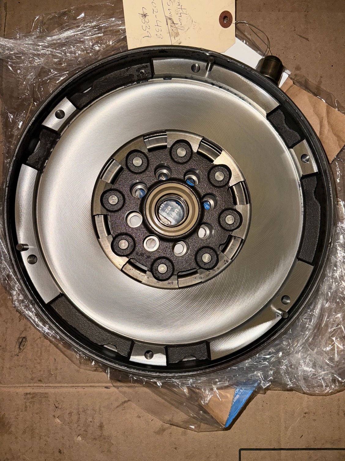

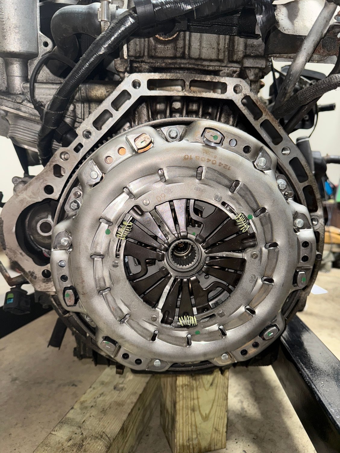

clutch was replaced with a new/oe and flywheel (for the sake of not spending an arm and a leg) was resurfaced instead of replaced.

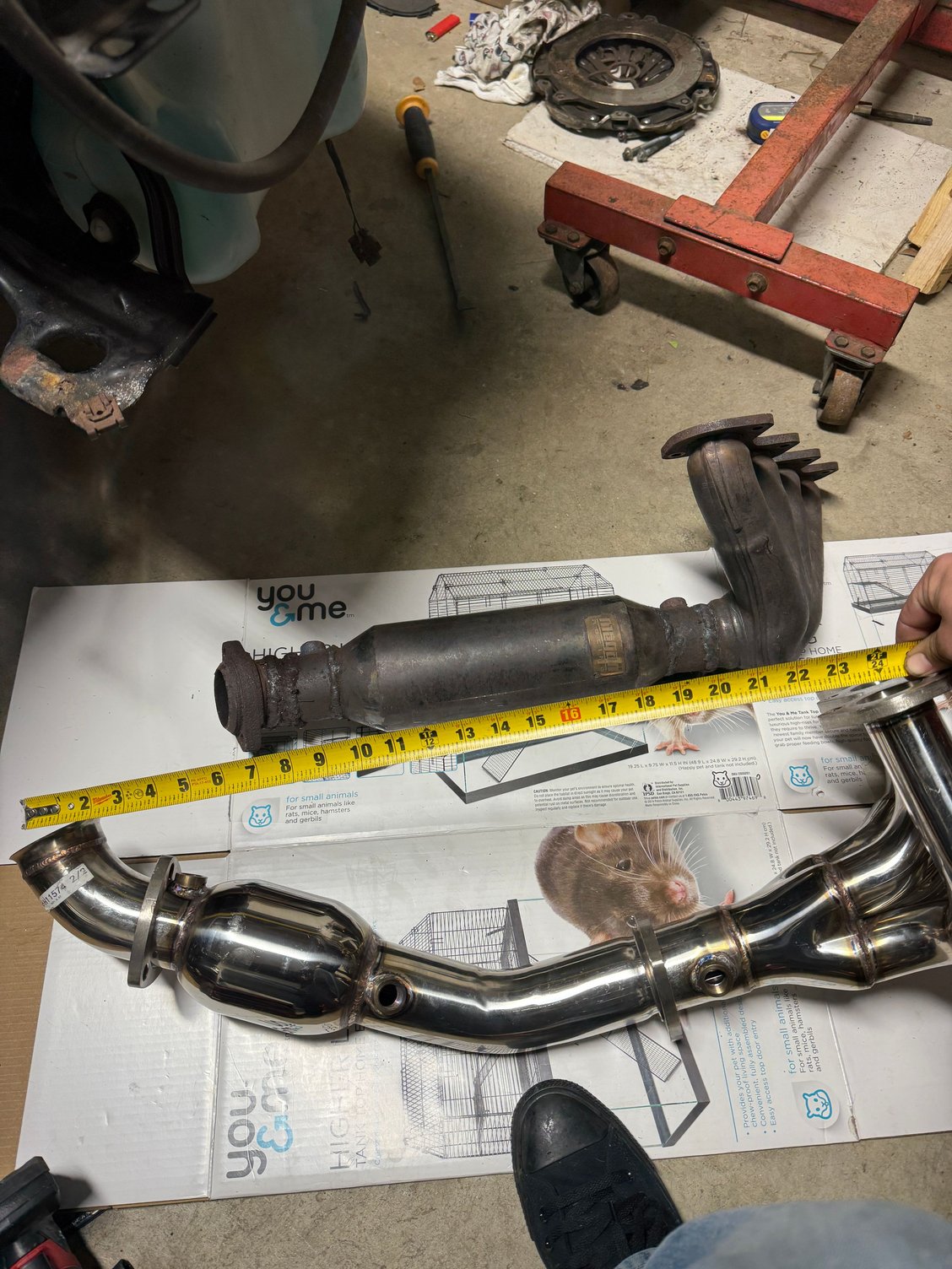

i also purchased a new aftermarket dp/ headers from Beckett exhaust which was listed as a direct fit but I believe either my flow master cat back has different connection points, or it’s the incorrect DP for the car because the headers fit, but the downpipe does not line up with a cat back.

After having the swap completed, got all new fluids installed and ran the car a couple of miles. at this point the car is running & driving. Gears feel great, clutch feels great, the power in the car feels great as well. Had to reinstall the old headers/dp because the new 1 would not line up. But still had an o2 sensor code. Replace BOTH o2 sensors because why not? I’m already there and have the exhaust off.. might as well, and guess what? Still has an o2 sensor code. At this point I’m thinking it has something to do with that junkyard welded exhaust. Aside from throwing another o2 sensor at it or spending the cash for an OE exhaust manifold w/dp I’m not sure what else to do.
