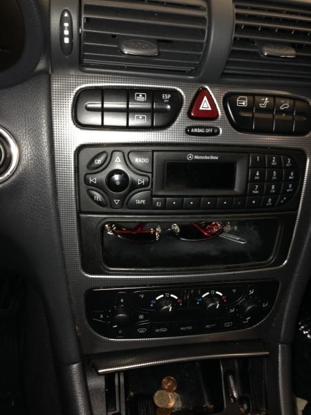

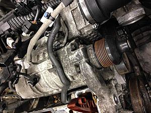

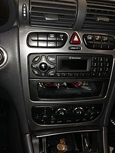

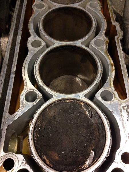

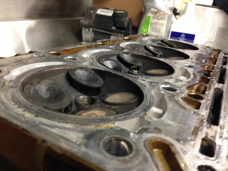

I was able to disassemble the cylinder head yesterday and determined I will not be repairing the engine. The timing chain jumped and all the intake valves are bent leaving nice indents in the piston tops. I will be parting out all the other engine parts... power steering pump, supercharger, alternator and so on. I took a few pictures of the interior which is in pretty good condition minus the 2 missing grab handles. Also the engine wiring harness which only has 30,000 miles on it. Both oxygen sensors, complete exhaust system with catalytic converter.

Benztech, read this thread: https://mbworld.org/forums/c-class-w...e-apart-3.html
Look at post 53. Your pistons might be ok. Those deep grooves are supposed to be there.

I decided to rebuild the cylinder head, replace the timing chain and get the engine running. Installed the rebuilt head and timing chain this past weekend and the engine is running great. I apologize for the delay in an update. looking to sell the car now.
