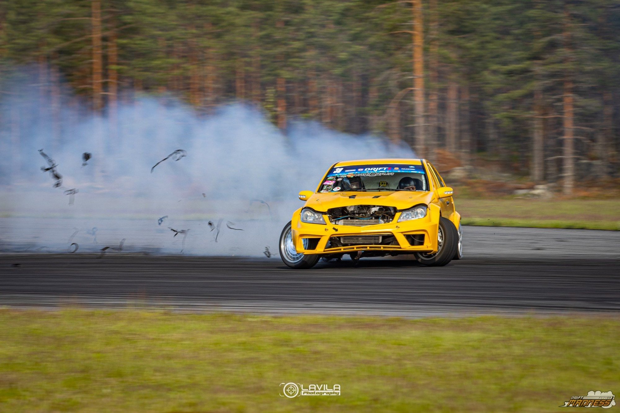

Hello all!
I've been building MB:s for drift use since 2016, and i would like to share my current W203.5 project with you!
Car is based on W203, but front end is upgraded to look like W204 C63 AMG Black Edition. Front suspension is 90% self made. Rear suspension have same geometry than OE, but with upgraded arms.
Engine is based on M111.955, but crankshaft is from M111.982 and connecting rods are H-profile type. Camshafts are made from OE intake cams, and intake and exhaust manifolds are self made. Turbo is 60mm Holset.
I've been having fun with this build since 2021, and hundreds of tyres have been burned since that!
@lavila_photography
@lavila_photography
[img alt="https://miwaazmedia.kuvat.fi/Photot/
"]https://cimg4.ibsrv.net/gimg/www.mbworld.org-vbulletin/2000x1333/img_2612_625d02c282fc8e5febfe2bb78e11106f81e4e44d. jpg[/img]
Thank you for your interest! If you want to know more from this project visit at my blog page (sorry for Finnish language) https://www.vakiopaja.fi/blogi/ or give me a note and i will update this thread!
