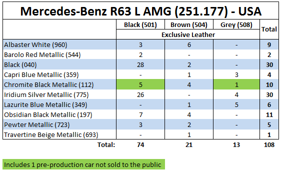

Can anyone confirm how rare the R63 actually is?
108 sold in the US.
Attached Thumbnails What's the consensus: how unreliable are these bad boys?-r63-us-production-data.png
