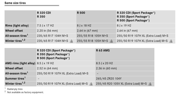

Could you attach a picture of standard 17" rims for R-class?
I am thinking about buying a set of 17" for winter. Hope, it should be Ok to put them on instead of factory 19"

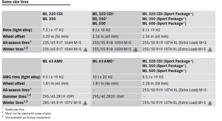

Good info HoD!
Did you get OEM R class wheels?
7.5 J x 17 H2 with 2.20 in (56 mm) offset?
Just did some research and the 2007 M class 17inch wheels had same size and offset. May be much easier to find than R class. see attached.
You may find some at scrap yards too. I missed out on a set of R class 19 inchers last year... was looking for a rear quarter window glass and the used parts lot had a set of 19 inchers at a really good price... 2 weeks after I got new 18 inch summer tires... grrr.
Attached Thumbnails Tires question, 18-inch-m-class-2007-om-wheels-tires.jpg   Tires question, 18-inch-r-class-2007-om-wheels-tires.jpg
He He He... actually in various years the M and GL have had the same wheel in various sizes...
For Example
Silly me thought that was common knowledge.....
Old Jul 1, 2015 | 10:09 PM
  #33
efzauner's Avatar
Joined: Jul 2009
Posts: 938
Likes: 53
From: Montreal, Canada
2005 C240 2011 R350
Well... Mine has 18 inchers and if you look, the M and R have 6mm different offset... so I did not think they where the same setup....now you would say that 6mm is splitting hairs...
