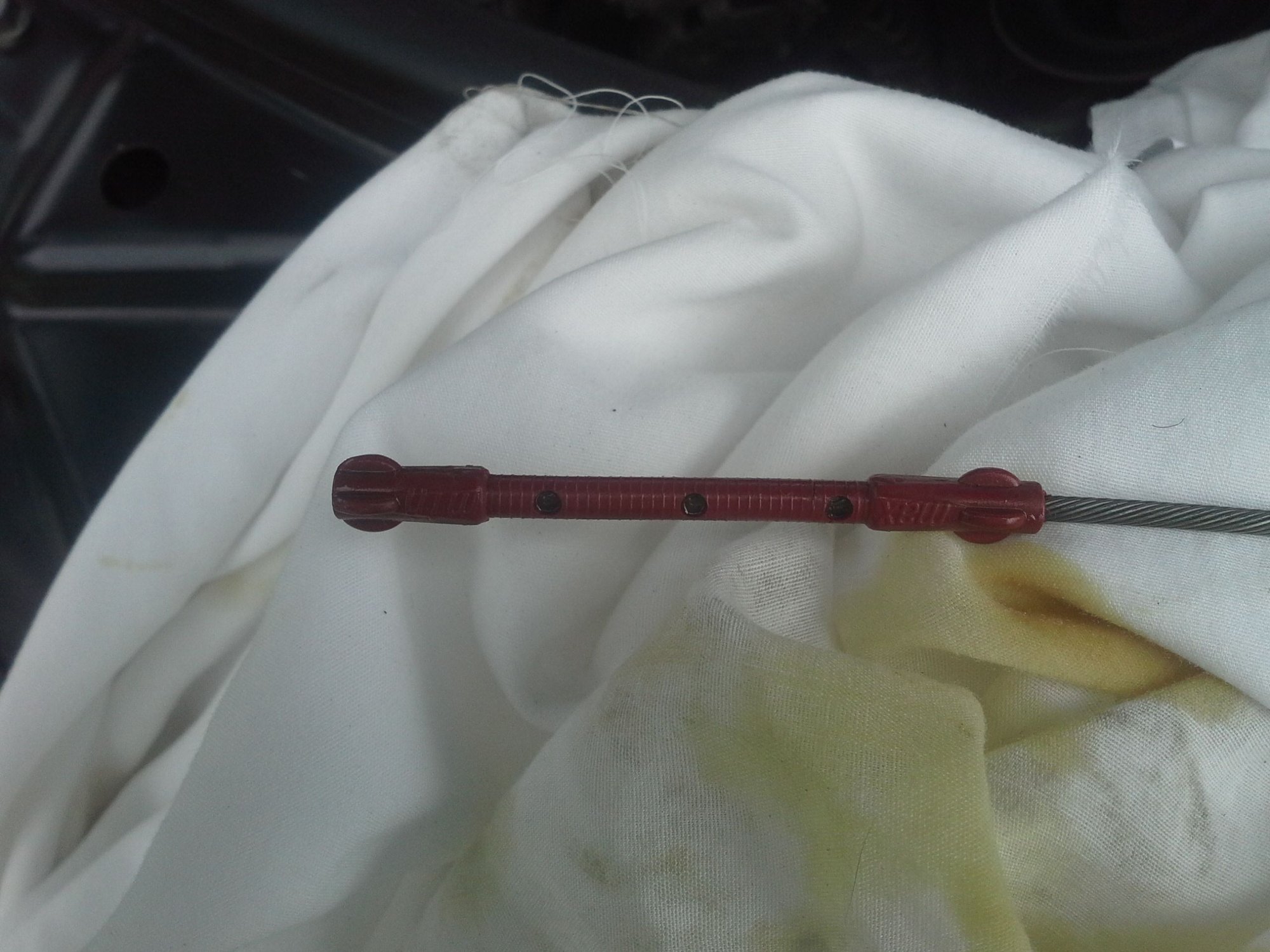

So good news bad news. The oil change was very easy, but that was because I am missing the protective under cover. What is it called and about how much? Also I can look it up later but what type of power steering fluid is needed?

Where on the stick should I fill too?

Right in the middle of the fill zone. You should see a cross-hatched section on it.
If the engine is hot, you can fill it to the top line.
After you add the oil start the engine, let it run for a minute then shut it off. Wait a few minutes and check the level again.

Just min and max. I put a little over 8q in which was halfway. I started drove around and shut off. Now its up to the screw near the max. Should that be good?

Yes, that is fine...
