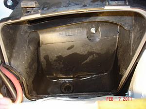

Look at the thread on chaging your cabin air filters from the engine compartment side. Once you've pulled the cover off, you just need to make sure there are no leaves or debris in the bottom or in the drain. There is a rubber lipped diaphragm you can pull out with your fingers or a pair of needle nose pliars.Total time to do it all is probably five minutes.
Originally Posted by jwratts
Does anyone have pictures of the problem? Is it a repairable item our do you have to continually keep the drain clean?
Old Feb 12, 2011 | 06:09 PM
a930rocket's Avatar
Joined: Nov 2010
Posts: 80
From: Mount Pleasant SC
R350
Here's the bottom of the air intake box drain showing the rubber diaphragm before and after removal.
Attached Thumbnails Has your blower motor and/or carpet been damaged by water intrusion?-dsc01961-800x600-.jpg   Has your blower motor and/or carpet been damaged by water intrusion?-dsc01972-800x600-.jpg
