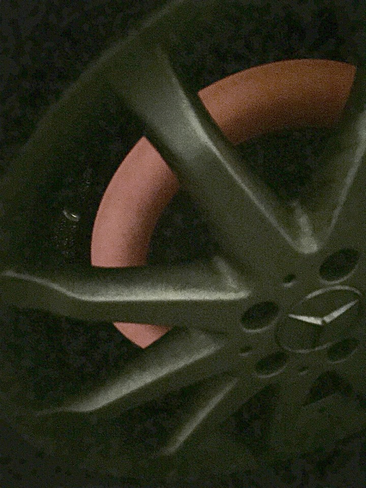

2006 R350... weird nose on the highway, going on for about 2 kms before I could stop, at 60 mph, here is what it looks like.
The disk was super red and I could feel the heat when I approached my hand at over one feet. I pulled and released the parking brake 2-3 times when I stopped in order to reset the system.
According to the internets, steel gets that red at over 750 F.

It sounds like your rear parking brake seized (drum brake pads inside the hub).

or your rear calliper seized - that's very common.

After that kind of heat, you will probably need to replace the rotor, calliper, pads, e-brake pads and do a brake fluid flush.
Make sure your wheel bearing is still good too.
