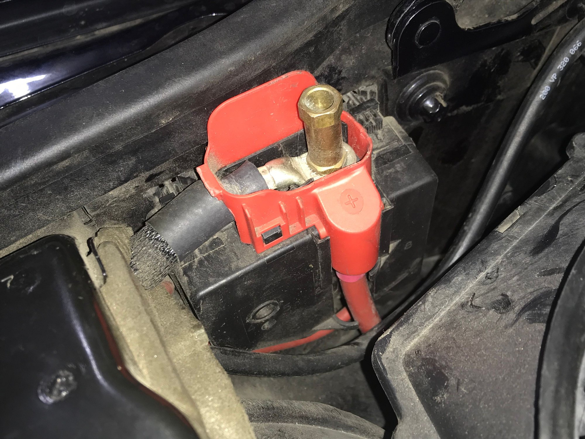

I’m seeing conflicting information. Does the 2008 R350 have a pre-fuse box under the hood, passenger side next to the heater air inlet?
I’ve taken off these wires, but can’t figure out how to get in to the black plastic box. Does it have primary fuses in it?
Trying to diagnose: ABS error code 5967 power supply high pressure pump, so looking for the primary fuses.

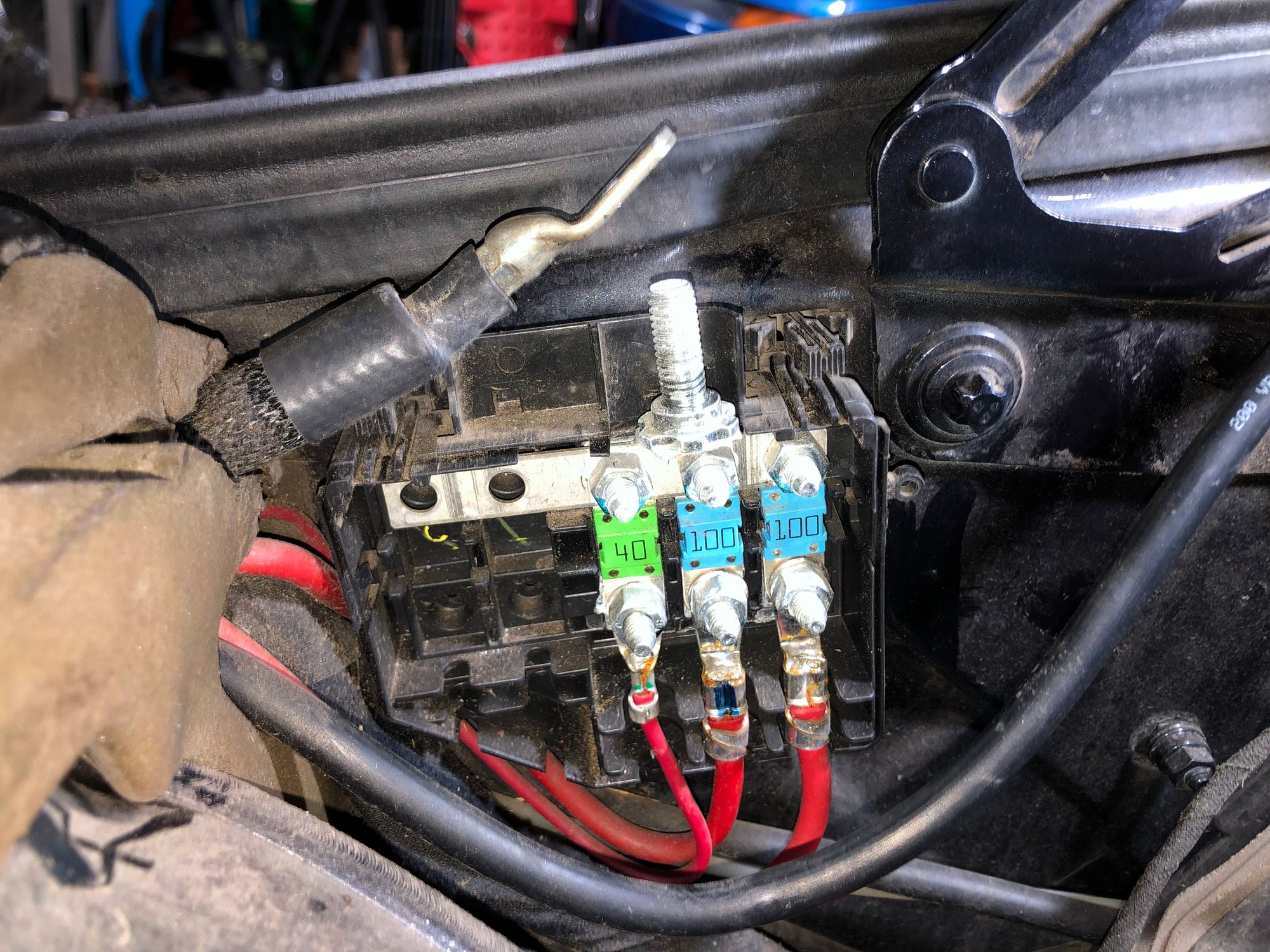

After a bit more effort, was able to get the cover off. Removing the air inlet helps.
