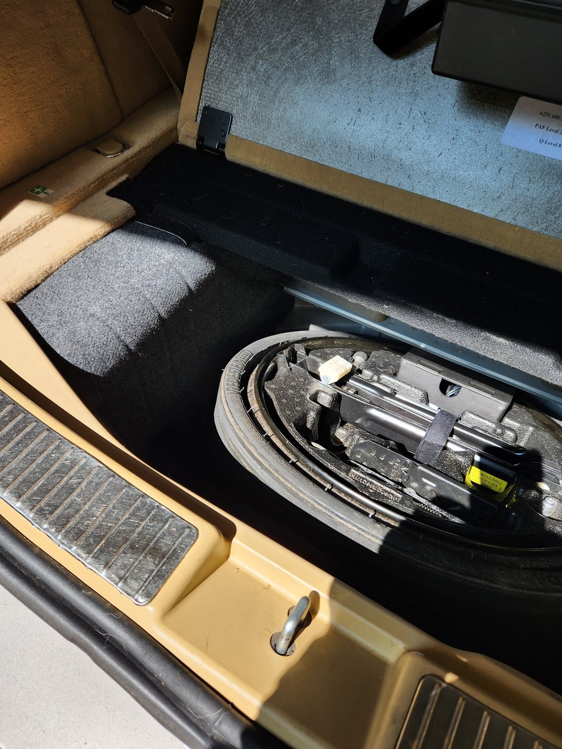

I refilled mine. It was easy to do. Remove the spare tire and the cargo well cover to access the pump on the driver's side of the cargo well. I filled the empty reservoir a little more than half way and cycled to push the new fluid through the system.

Sep 7, 2024 | 07:20 PM
Quote: lower left size covered by a foam cover.
I couldn't find it, how about a pic or more detailed description of the location? (2006 R350)

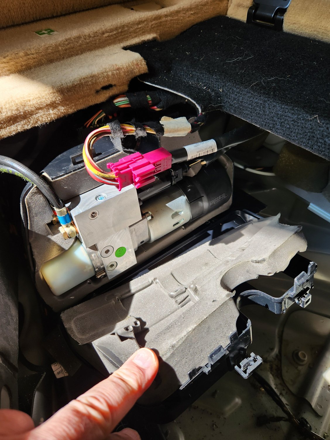

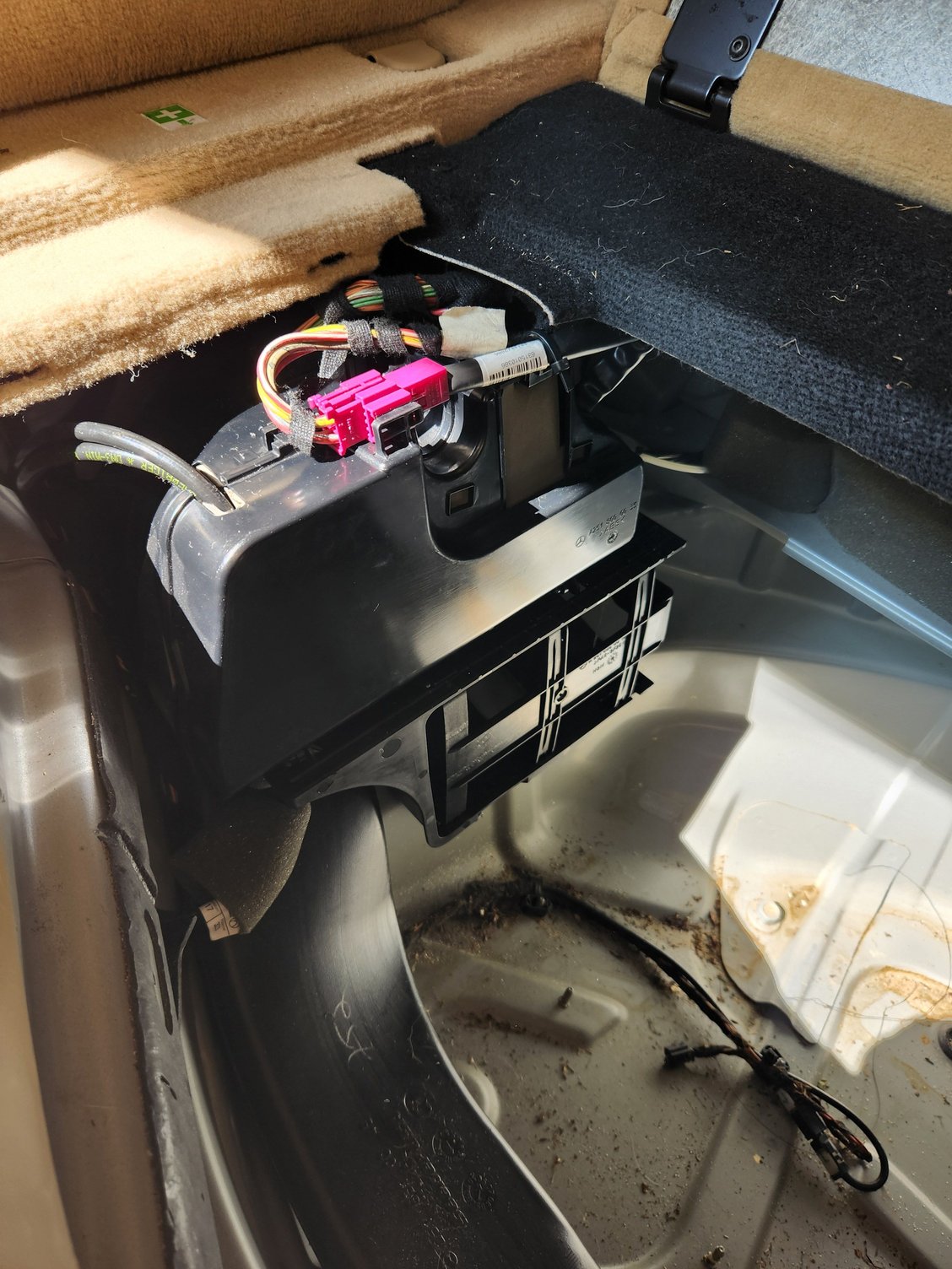

Sep 9, 2024 | 12:14 PM
Here are the steps:
Remove spare tire
Pull back grey cover on the side. It has tabs across the top and clip in at the base of the spare tire well.
Unclip and open the plastic box that holds the pump. You'll need to cut a zip tie for the cable and have a new zip tie to secure when finished
Pull out the pump and then you can fill up the fluid reservoir.
Hope that this helps!

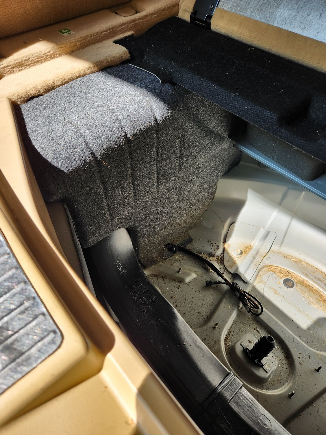

I pulled the spare out and looked all round the area, took out all the grey covers and especially paid attn to the left side where you show the pump - but - either the pump is elsewhere or PO has removed it? There was no trace of a pump or anything else under the grey cover on the left. Very odd!
Reply 0
Sep 16, 2024 | 09:19 PM
So you don't have the black box in photo #3? On the GL the pump is located on the right side. Maybe MB moved it at some point? What year is your R class?

Sep 16, 2024 | 09:24 PM
Hi, thanks for replying! My car is a 2006 R-class. No black box etc ...we thought if the pump had been removed there would still be some traces of it being there, like the hoses and electrical connectors perhaps? on the rightbside we have the fusebox btw.
Reply 0
