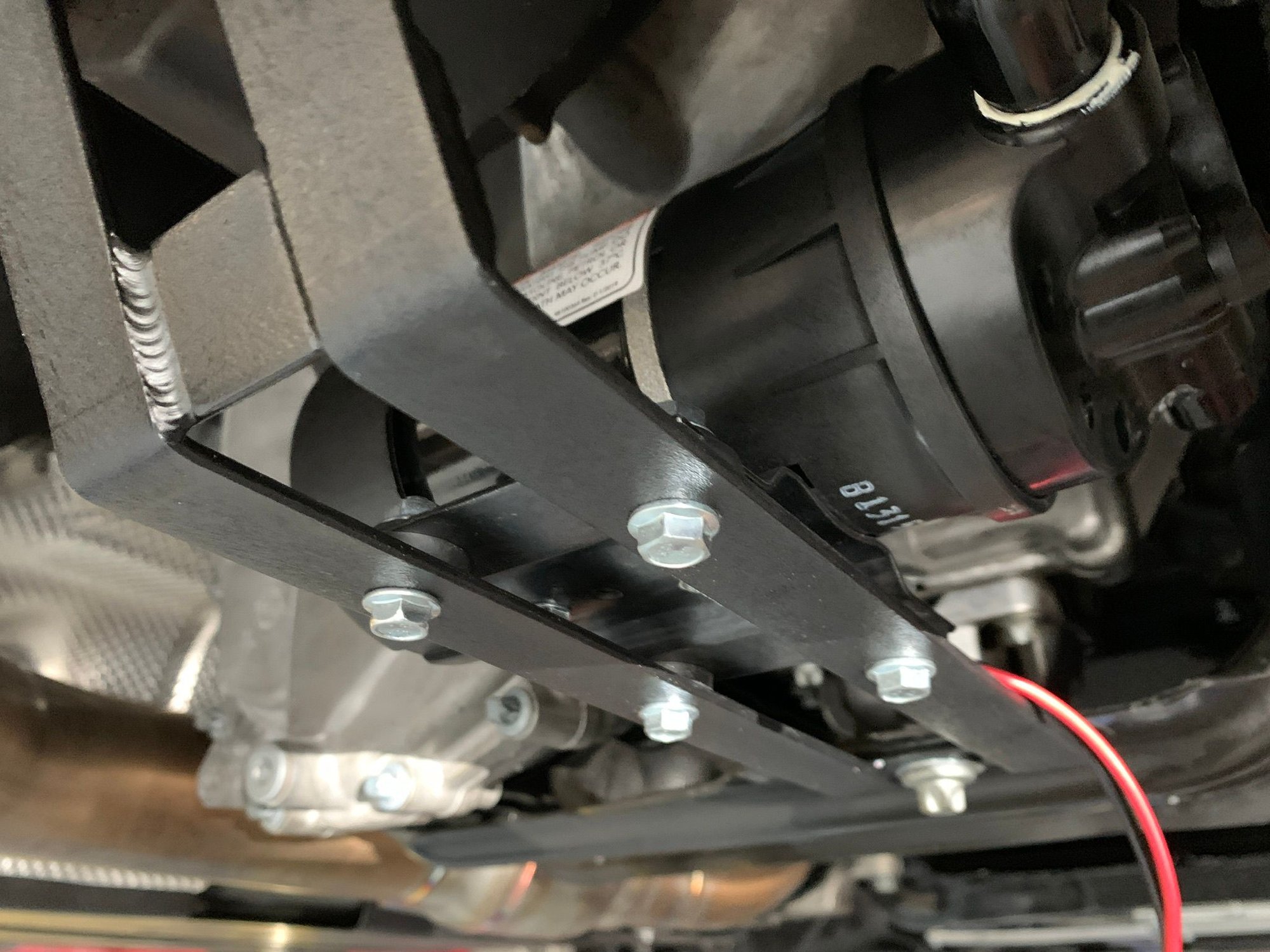

With that said, I spent a lot of money on upgrading my 7G with the Weistec kit plus converter. My original trans was fine but after adding the supercharger I wanted to make sure the rest of the drivetrain could handle spirited driving. I did two things to manage my trans temps for extreme conditions. The easiest upgrade is the Weistec trans pan. This aluminum pan has cooling fins and allows for additional fluid. The second requires more work and there isn’t an off the shelf solution. Weistec designed and installed a custom stand-alone pump and cooler that can be turned on manually or automatically.
These shots were during fitment/installation and little things like the long exposed bolts were properly sized when finished.
Also, as stated earlier, this is a custom installation that is not currently offered by Weistec or anyone else that I know of. If you contact them they know the car very well but may not be able to provide parts for this upgrade.
