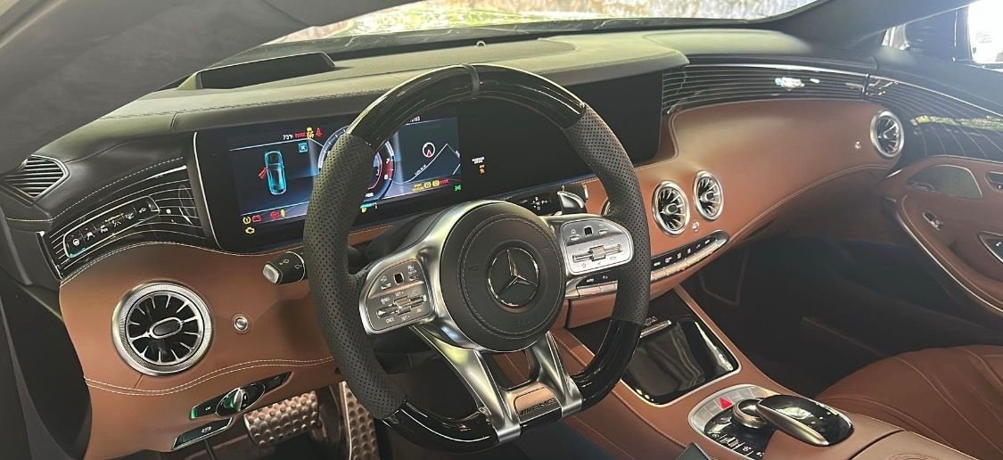

I love my new vents
This was the best money I’ve ever spent on a car.  I think this should have been the way they came from the factory.

Looks nice.
Any Night pics?
Was the install difficult?
Did you run the wires through driver's door or passenger's door?
Didn't wire them. If I do, the instructions say the passenger door
