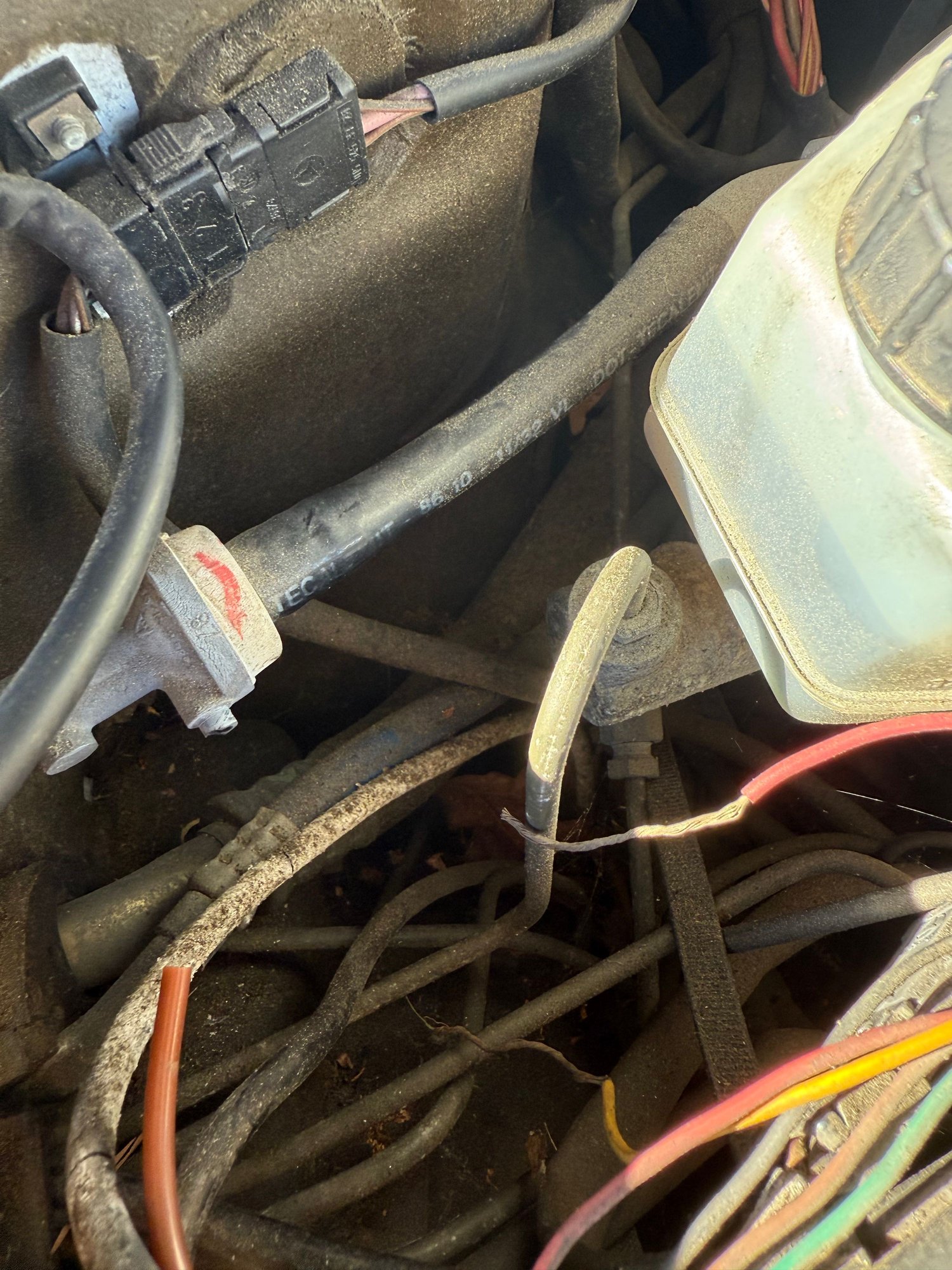

Hi all. I have been having problems with the vacuum system in my 300SDL and so I tried to test my vacuum pump. I pulling the vacuum line off of the t-shaped check valve that goes into the brake booster vacuum line and ended up breaking it as it is very brittle. I cannot find the check valve anywhere and it seems like it is almost impossible to get out of the vacuum line anyway without at least using a heat gun. I tried looking for the complete vacuum line along with the check valve so I could replace the entire thing but I cannot find one anywhere. I have also looked at making my own but I am at a loss as I cannot find the check valve anywhere. Could someone please point me in the right direction in regards to what parts I could order, preferably with links to the parts? I have included pictures so I hope that helps. Thank you.
