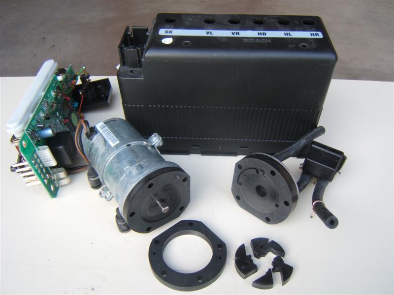

My vacum closing assist pump (located in trunk) gave up. Upon inspection this is what I found ... pic... Does anyone Know of a repair depot or where a replacement part can be purchased......dealer only wants to sell new pump assembly. Seems a waist to have to throw the whole pump away for such a small part. 94 S320 W140 sedan just clicked 290,000kms Vacum pump-dscf1152-medium-.jpg

Might be worth looking to get that one part fabricated by a local shop?

That would be a difficult part to fabricate. It's a composite material. Junkyard maybe? Or post a "Wanted" on the various forums?

Don't think you'll find one of them anywhere BUT you may place a request for a faulty unit and recover the part ?? or as the previous poster listed get one fabrcated, may not be that expensive... maybe a friendly model maker type person may be able to knock one up in an alloy material failing that try the arodite route what have you got to lose.

alfred try the benzworld forums in the w140 section.zidbenz you can find trunk pumps in wrecked cars,I've never heard of them being replaced as they can be adjusted
