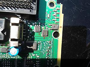

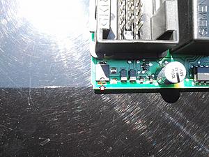

thank you for your response,and yes the blower motor wont stop running i changed the regulator twice and still have the same problem.with the key out and fuses 20,21 removed the climate control out also it still keeps running ,I have to unhook the battery to shut it off ,I taken the climate control apart and i do see what looks like small burns in three spots,I had no control over the buttons no response on most of them i would like to send it out to be repaired but have no clue to where if you know of a place i would like to know ,I got this car at an auction and i' m retired due to a bad ticker so i was just haming around with it you know to much time on my hands and just can't stand sitting around, any way thank you for your help and i will take heed to what you've said.

ronsaun, you are not the first to suffer that, MB have change several suppliers for the climate control module, it has proven to be a nuisance, Kcscout is also right you might want to make sure all wiring harness are in good condition as the deterioration of the dreaded wiring harness disease is imminent in this S class series. my best bet is on the climate control module (assuming the blower speed regulators are in good condition). Take a look at the button where the word REST is written, after taking out the keys see if the REST will activate after a few minutes of shutting off and pulling out the key. If it comes on then you definitely would want to purchase a new control module or have it fix. first supplier was Kremer then came Bosch.

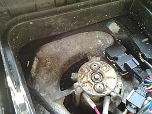

I can't get it to shut off so I couldn't check the rest button,and I felt the wires running off the side of the blower and they felt really old it's just two that connect,don't think i can replace them tho they run under the housing and under the vent,the blower looks really rusty to me what do you think about it.so thanks to all for all your help you've been very kind to a rookie.Ive been trying to get these pics to you all-all day

the rust on your blower motor is due to the seal on the plastic cover which may have deteriorated, replace it and make sure the bolts are properly in place. try to take out and disconnect the socket connected on the climate control module and see if the blower stops, it is does then you have eliminated the wiring problem. let me know what happens after this step.

i'll gt another new one i have replaced it twice cause they both acted the same way ,did you see the pics of my climate control there were four spots that looked like they could be trouble ,to me any way what do you all think.thanks for your input i do value what you guys say.

yes I did what you said.and its bad,I also pulled the blower motor and the bushing are bad I took it to a shop that fixes starters and was told the bushing were bad he could move the blower fan in any direction so I need another one right ?,I see why the car was at the auction now.but i git her done it'll take some time but that's all I got

oh the pics of my circuit board are in the 13 th post,Id still like to know what you think
