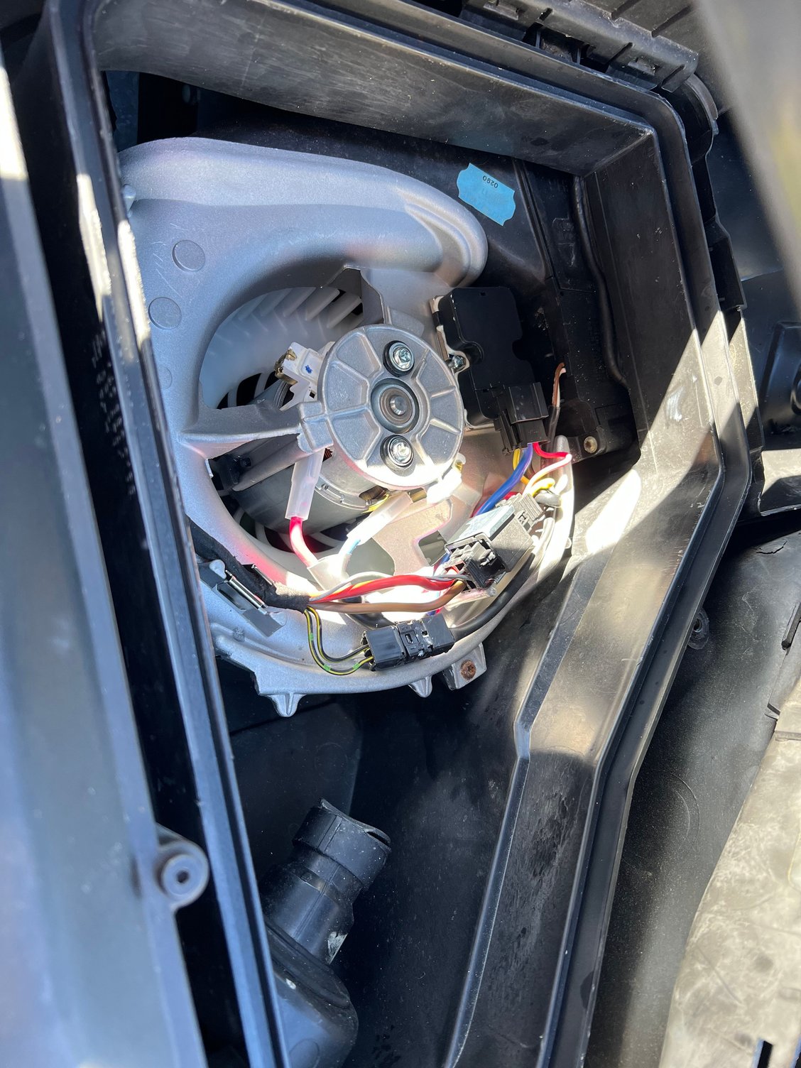

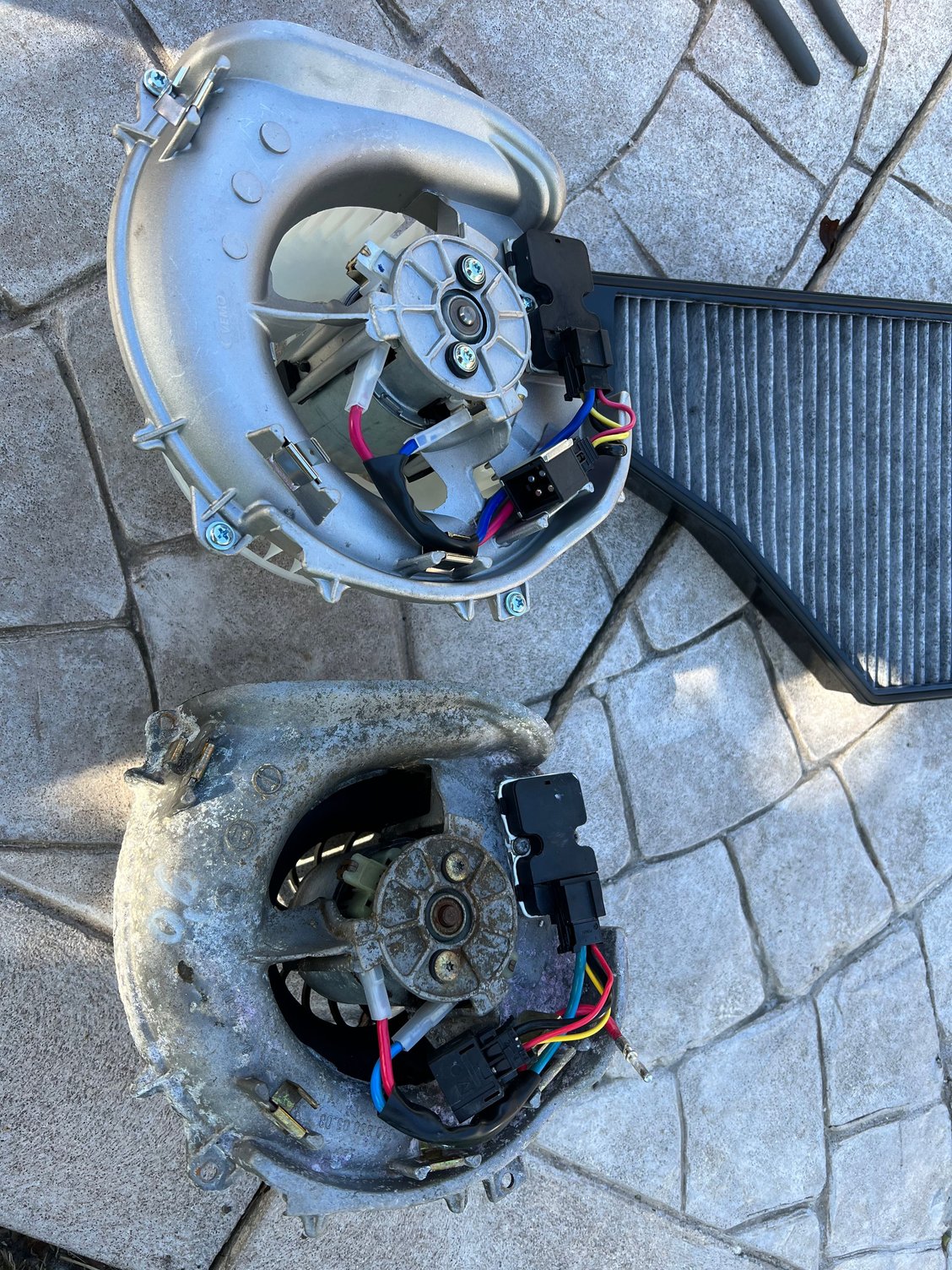

Don’t replace just replace the resistor blower control. I got mine off Amazon for $27.00 and installed it and guess what? Yup the brandnew FPOS resistor control was junk. Before I had no blowing motor and now i had the pleasure of one speed and when I turned the car off the blower motor did not shut off! I had to disconnect the battery. The Dealer wanted over a $1k for this repair 🖕🖕🖕
you need a Phillips head screw driver, a #20Torx and about a 1/2 hour. ( if you did a 2nd Blower motor it would take you 5 minutes) Make sure you disconnect the battery. ( you will have to reprogram windows) Good opportunity to replace cabin filter.
