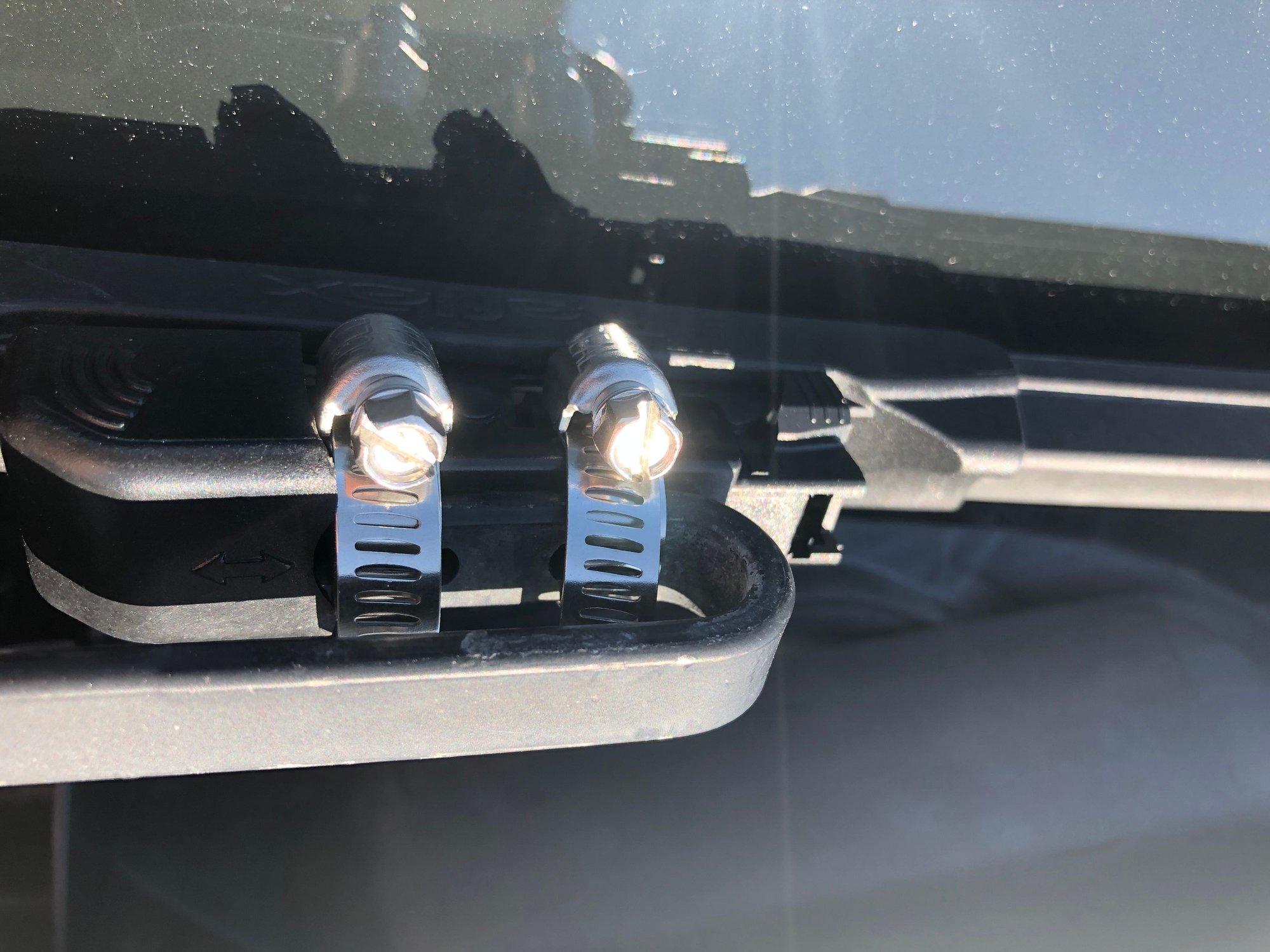

The recommended wipers for my car would not fit with the U Hook connector because the wiper arm is wider than the wiper.
Found a quick fix though that would work in a pinch. Use the straight connector attachment, turn the wiper upside down, and connect it with a couple small hose clamps.
Won't be winning any car shows but will get you home in a storm if you ever lose a wiper. It clears the under side of the hood just fine and I have driven with them on high through some heavy rain without problem.
